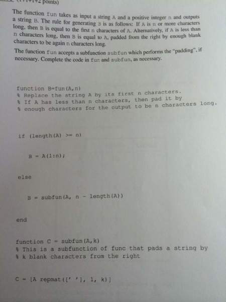

This is a problem from a previous exam. The exam is done by hand, I'll send a picture
Here is an exam question from a different year. It's clear that the instructor likes sub function problems on the exam
