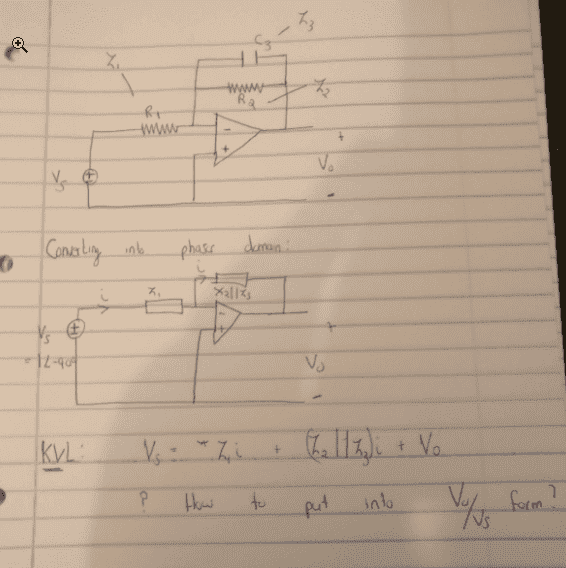

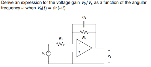

Inverting op-amp circuit with input source Vs feeding resistor R1 to the inverting terminal, and feedback network of capacitor C1 in parallel with resistor R2 to output Vo.
Handwritten op-amp circuit in phasor domain: input source Vs = 12 at -90 degrees through impedance Z1, feeding the inverting input, with feedback impedance Z2 parallel Z3 and output Vo; below it the KVL equation Vs = -Z1 i + (Z2 || Z3) i + Vo.
[/B]
My approach was to put them into phasor form and do a KVL loop. However I don't see how I'm going to get Vo/Vs in here?
Vs = i(Z1) + i(Z2 parallel Z3) + Vo

My apologies. The final equation I got was this. Where Z1 = resistor impedance, Z2 = other resistor, Z3 = capacitor impedance
An additional equality for an ideal OP-AMP, differential input is zero, i.e., v+ = v–
Write a pair of equations having i on their left-hand side, then equate them so the i term disappears, leaving you with an equation relating output voltage to Vs.
