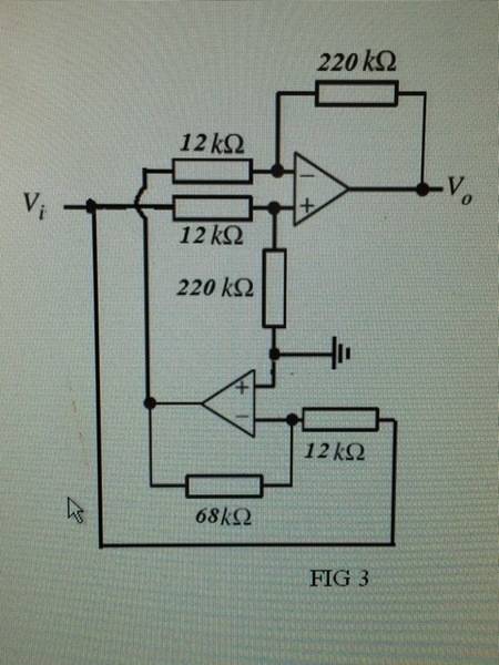

Find the voltage gain of Vo/Vi. I'm pretty confident I have this down now, but I'd be greatful if someone could confirm I have this sussed.
For the inverting op amp:
[itex]Vo= \frac{-R2}{R1}*Vi[/itex]
For the differential op amp:
[itex]Vo= \frac{-R2}{R1}(V--V+)[/itex]
[itex]Vx= \frac{-R2}{R1}*Vi[/itex]
[itex]Vx= \frac{-68}{12}*Vi=-5.667Vi[/itex]
[itex]Vo= \frac{-R2}{R1}(Vx-Vi)[/itex]
[itex]Vo= \frac{-220}{12}((-5.667Vi)-Vi)[/itex]
[itex]Vo= \frac-18.3(-6.66Vi)=121.878Vi[/itex]
[itex]\frac{Vo}{Vi}=121.878[/itex]

The result looks good.
You might want to sprinkle a few comments around in your derivations so that it's obvious what your steps are accomplishing. It was a bit puzzling at first to see the same symbols, R1 and R2, take on different values with no apparent reason.
I've read this exact problem this morning and got 122.22. It may not be as exact as your answer but it's just the same. Just make your solution clearer to avoid confusion.
