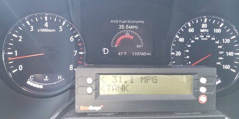

Tom.G said:
If your car is a newer one with a fancy computer, there may be a function to display MPG in near real time.
I read a comment on PF (a long while ago and I can't remember the context) that the mpg display may not be as reliable as you might think. It is not (apparently) arrived at by measuring the actual flow rate of fuel but by measurement of the engine parameters.
In the 70's there was a craze for mounting fuel flow measuring units in cars and a take-off at the speedo input and that could give reliable mpg results. But it would involve a bolt - on which few people would bother with. (Drilling holes in the dash board is not a popular hobby these days. :smile:)
It's a good chance I was involved in that discussion, but I don't have a lot of sympathy for the manufacturers, if that's their excuse. There are lots of things you can measure that make good proxies for fuel flow and cars are so exquisitely well engineered/sensored/controlled that they know with a very high degree of accuracy what the fuel flow is. That makes it more unforgivable that car trip computers are inaccurate and more likely that it is done on purpose (anyone ever see one with an error low?). To put a finer point on it, you can buy a 3rd party device that reads your computer's telemetry and (among other things) functions as a very good trip computer:
I still use this because it is more accurate and comes with a calibration function (and I'm nerdy like that), whereby it guesses how much fuel you just put in the car and then you correct it. The gallons and correction factor (in %) are then shown. This device tends to run 1-3% high (varies based on weather and driving conditions/style), vs the car's trip computer which runs 10-15% high. Given that they have access to the same information, there is no excuse for that extra 10% or so error.
Note: this is a Kia Optima, a company (not model) that had to mail customers gas cards for false advertising of fuel economy. My model was not included, but perhaps not coincidentally the current advertised fuel economy is about 10% below what it was for the model year I bought (31 vs 34 mpg highway).
