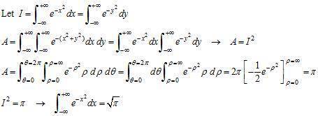

Hi !
(details of integrations in attachment)

Oh! Thanks very much for the help. :D
