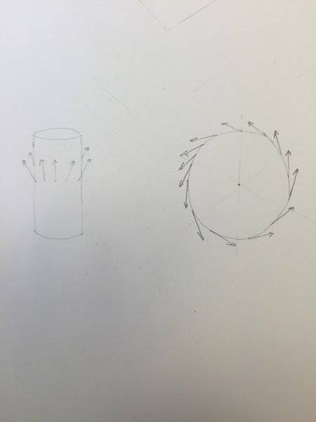

Also, when we make these symmetry arguments are we also considering the net electric field at each point? The reason I ask is that, for example, in the case of an infinite plane of charge, couldn't one otherwise have a case in which the electric field is oriented at some angle to each point on the surface, but in such a way the the electric field is radially symmetric about each point. In this case, one could move to another point and it wouldn't look any different - the symmetry would not be broken?! Is the point that each charge produces an identical electric field and so their resultant field lines will all point in a particular direction at each point (for example, you won't have some pointing north-west and some east etc. , they will all point north-west), and hence, this direction must be perpendicular to the surface, otherwise, I could walk along the surface in one direction "against" the electric field lines, and then rotate 180 degrees and walk in the same direction as the field lines, thus violating the planar symmetry?!
For example, I can see why it must be the case that the field must be perpendicular in the planar case
Since, from the couple of cases on the diagram above, even if the electric field is oriented at a different angle at each point, the planar symmetry will be broken.
But in the cases of cylindrical and spherical symmetry, I can't really argue why these configurations aren't allowed by symmetry:
Imagine that you have in front of you some charge distribution and its associated E field. Think of the field arrows/lines as "attached" rigidly to the charge distribution.
You close your eyes, I rotate or translate the system, and you open your eyes again.
If the charge distribution "looks the same" as before, i.e. you can't tell that I've done anything to the system by comparing the charge distribution to what it was before, then the field configuration must also "look the same" as before.
For your cylindrical example, suppose I flip the cylinder end for end. Then your field arrows now point downwards instead of upwards. The field "looks different" even though the charge distribution "looks the same".
Similarly for your sphere, rotate it 180° around any axis that lies in the plane of the paper. Now the field arrows point in a clockwise direction instead of counterclockwise.

Ah, good point. I hadn't thought of those as valid symmetry operations - I've been thinking too much in terms of 2D geometry instead of 3D. So, for the sphere, is the point that whatever angle I orient electric field lines to the surface of the sphere this will always lead to inconsistencies (apart from if they are orthogonal to the surface), since we can rotate the sphere about any angle and the charge distribution doesn't change and so the direction of the electric field at each point shouldn't change. The only way this can be true for any rotation is if the field lines point radially from the centre.
