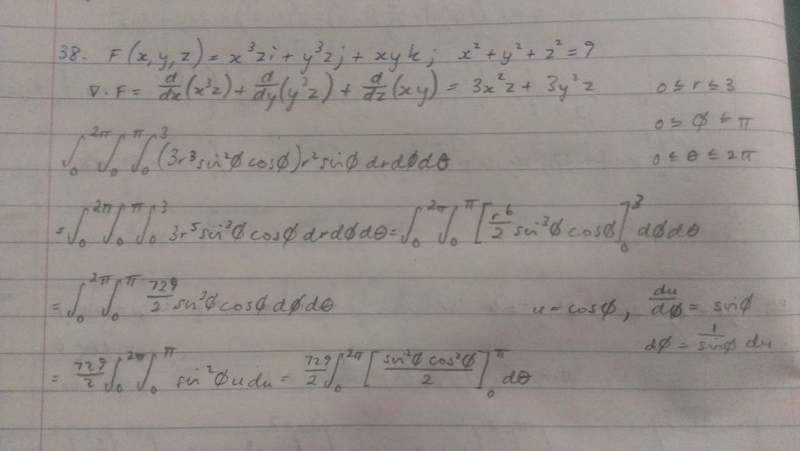

schmiggy
37
F(x,y,z) = x^3zi + y^3zj + xyk
across the surface x^2 + y^2 + z^2 = 9
See attached image
See attached image.
I'm fairly certain there's either something wrong with my initial integral, also I don't think I integrated correctly with respect to phi.. but I'm not really sure how to fix it.
According to my exercise book solutions, the answer is 0, however if I were to continue with my working out I would get 729pi.
Any help would be greatly appreciated, thank you.

You did the last integral wrong.
Use the substitution u = sin φ
In terms of u the integral becomes
$$ \int_0^\pi \sin^3\phi \cos \phi \ d\phi = \int_0^0 u^3 du = 0 $$

hi schmiggy! :smile:
your 3x2z + 3y2z was right,
but then you only converted the 3x2z into polar coordinates! :rolleyes:
(btw, that's 3r2z, which is odd in z, so isn't it obvious that its integral over that sphere will be zero? :wink:)

No tiny-tim, I think he did it correctly.
3x2z + 3y2z = 3rcosφ(x2 + y2) = 3rcosφ(r2 - z2) = 3rcosφ(r2 - r2cos2φ) = 3r3cosφsin2φ
which is what schmiggy got
oops! :redface: i was thinking of cylindrical coordinates! :confused:
thanks, dx :smile:​
(but my comment on "odd in z" still stands :wink:)
Firstly, thanks to both of you for the help!
I got the integral to result in
$$ \int_0^\pi \sin^4\phi/4 = 0 $$
(sorry, not sure how to use that code to format the integral properly, basically it's sin^4(phi) multiplied by (1/4))
I embarrassingly sat for about 2 minutes afterwards going.. "but when I integrate with respect to theta, I'll end up with 2pi..." before realising I was integrating 0. /facepalm
Anyway, thanks again!
Hi schmiggy,
I think there's something wrong either with the latex or quoting. I was talking about the integral over phi at the end
∫ sin3φ cosφ dφ (from 0 to π)
which can be performed with the substitution u = sin φ to give
(1/4)sin4π - (1/4)sin40 = 0
I accidentally edited your quote when I was playing around with the latex seeing how it works, my bad! I also accidentally left the d(phi) at the end. I've edited my previous post and that should be correct.. I hope.. or else I'll have a serious case of egg on my face
