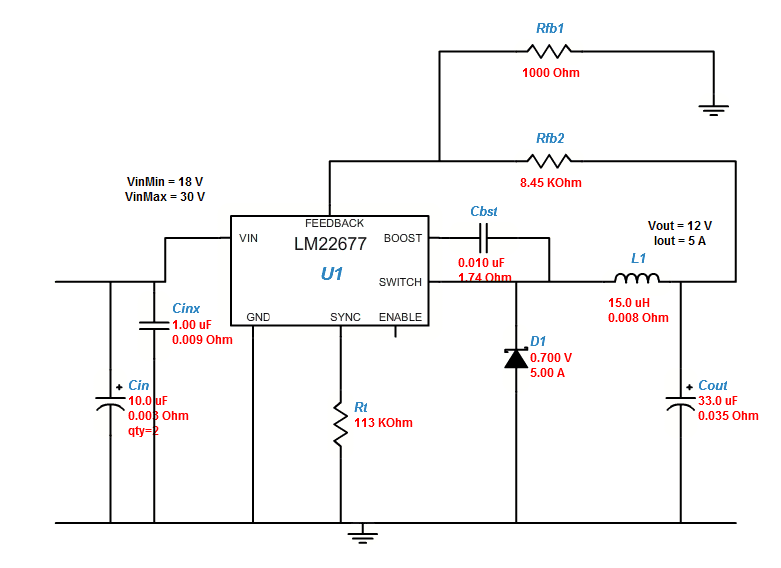

What do you think of this LM22677? http://www.national.com/pf/LM/LM22677.html#Overview I have it to produce 12V/5A... any idea how to get it to -12V/5A?
Schematic of a buck converter built around an LM22677 regulator, with input VinMin 18 V and VinMax 30 V, feedback resistors Rfb1 1000 Ohm and Rfb2 8.45 KOhm, output Vout 12 V at 5 A, inductor L1 15.0 uH, and output capacitor Cout 33.0 uF.

Oh wait, problem solved! I was referring to the wrong page of http://cds.linear.com/docs/Datasheet/3758f.pdf
Much thanks for everyone's input!
