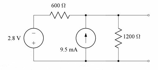

Consider:
... what is the voltage across the 1200 Ohm resistor?
1.9V, I think...
Jhenrique said:
I don't understand, your two paragraphs above are contradictory... in the 1st you says that very information can turn the system impossible. In the second you says that it isn't impossible...
In the first I am talking about specifying the voltage and the current for the same source and in the second I am talking about having voltage and current sources in the same circuit. The example circuit illustrates how this is not fatal.
1.9V, I think...
... well done: so you are saying that you can see how it is OK to have voltage and current sources in the same circuit?
Notice how the voltage and the current in each part of the circuit depends on all the components?
Notice how the voltage is not specified for the current source and the current is not specified for the voltage source?
If I had specified that the voltage source is putting out 1mA of current at the start - is that possible?
No!
And there you have it. All clear now?
