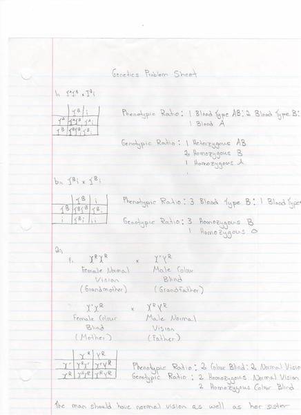

this is how i did it, its starts at question 2
Colour blindness is a recessive trait and therefore a female colour blind must be homozygous recessive and have both XrXr. A normal woman will be either homozygous dominant or heterozygous (XRXR or XRXr)
Furthermore the gene is absent on the Y chromosome. So a colour blind man is XrY and a normal individual is XRY
You may want to redo the problem.
