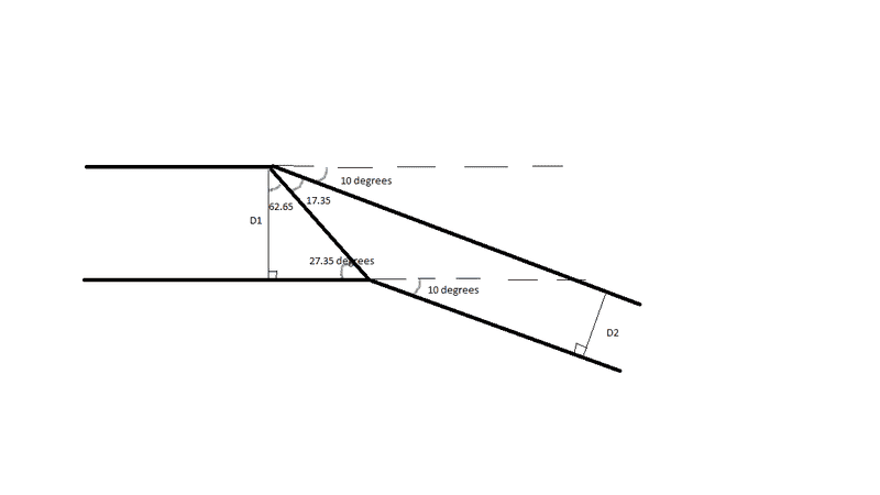

Find D2/D1.
See attachment.
Ans: D2/D1 = 0.68
I can't figure this one out. Any special trigonometric identities that might help here? Thanks.
  • Geometry diagram of a pipe that narrows then bends downward: two horizontal walls, a vertical height D1 on the left, a sloped section at 10 degrees, angles 62.65, 17.35 and 27.35 degrees marked, and a perpendicular width D2 across the outlet.
Draw two more lines to/from the point where the upper diagonal line intersects the lower horisontal line. One of them should be vertical. The other perpendicular to the diagonal lines. Now you have a rectangle and a bunch of right triangles to work with. Figure out all the other angles and draw them into your diagram.
One of the right triangles will have an edge of length D2. Use that to find the lengths of the other sides in units of D2. Keep doing that sort of thing until you have the length of D1 in units of D2.
