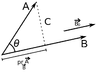

Hi! I am trying to find out where:
[tex]cos\theta=\frac{a \cdot b}{|a||b|}[/tex]
came from.
Here is mine geometrical interpretation of scalar projection:
Now, (pr means projection)
[tex]pr_{\overrightarrow{A}} \overrightarrow{B} = p\overrightarrow{B_0}[/tex]
and
[tex]cos\theta=\frac{|pr_{\overrightarrow{A}} \overrightarrow{B}|}{|A|}[/tex]
[tex]cos\theta=\frac{|pB_0|}{|A|}=\frac{|p|}{|A|}[/tex]
How do
[tex]cos\theta=\frac{a_xb_x+a_yb_y+a_zb_z}{|a||b|}[/tex]
for 3 dimensional coordinate system, wher |a| and |b| are modulo of "a" and "b" ?
Thanks in advance.
Regards.
Your use of the projection is recursive, since the projection of a vector use the fact that cos(theta) = dot(A,B)/|A||B|. Wikipedia offers a simple proof, look for the dot product. And the proof is valid in every dimension, not only in 2D.
Ohh, thank you. The proof is very simple. And why my use of the projection is recursive? The scalar projection equals |A| cos(θ).
But the dot product is hidden in |p|, and the way we compute the projection using the dot product uses the fact that we know that it's equal to cos(theta)/|A||B|. Explicitly, it looks like this:
1- Hypothesis: A dot B = cos(theta)/|A||B|
2- Use it to define projection
3- Use projection arguments to prove 1.
An inner product space is a particular type of normed spaces, thus it makes little meaning to say that the inner product is "hidden" within the concept of length.
Here, p is a scalar, that comes magically from the projection. And if it don't use the dot product to compute p, then I don't see the link between the dot product and cos(theta).
