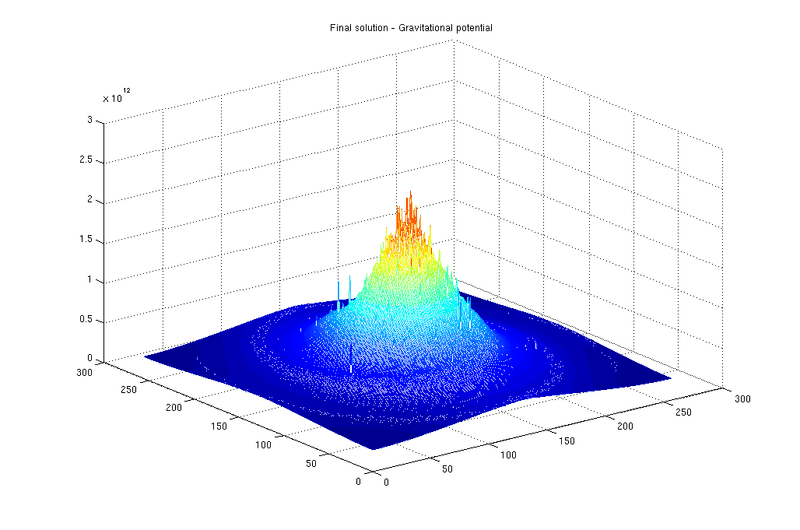

In the context of a project, I had to solve numerically Poisson equation with cylindrical coordinates. I put here results for z = 0 on a 3D mesh 256x256x256.
Below 1 figure representing the final solution (in absolute value) in the case of a galaxy; I use the CGS units for the potential.
I have 2 questions :
1*) I would like to know if the values that I get are valid with a similar real galaxy.
The characteristic features of this galaxy are : there are 10240 stars (each has 1 solar mass), the radius is equal to 25 kiloparsec (including arms).
A simple computation is done with the following formula :
abs(Phi(r)) = ∑ -Gm/(r-r(i))
For example, taking the positions of all the stars (10240 stars), I get for the potential at r = 1 kpc :
abs(Phi(1)) = 2.1 * 10^9 cm^2 s^-2
As you can see, I don't succeed to get the same value : look at near the center, I get approximately 2.5 10^12 cm^2 s^-2 : the difference is about 10^3, that's high.
Anyone could tell me why I don't get the same value for this radius ( r= 1 kpc) ?
In my code, I solve Poisson equation with discrete Fourier transform. Firstly, I compute the matter distribution (rho in Poisson equation) and after, the green function.
Here the code snippet for density (with space_x, space_y, space_y the size of a cell in grid, expressed in kiloparsec) :

Here the code snippet for green function (with Ng=256 in my case) :
Code:
for (i=0; i< Ng; i++)
  for (j=0; j< Ng; j++)
  for (k=0; k< Ng; k++)
  compute(i, j, k, node_x, node_y, node_z); // Compute the coordinates of cell on the grid
  density[node_x][node_y][node_z] = density[node_x][node_y][node_z] + mass/((space_x*space_y*space_z));
2*) When I define Green function, have I to add a factor space_x, space_y and space_z respectively for dx, dy, dz ? I mean like this below :

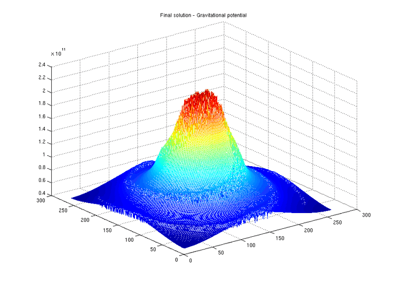

If I don't add these factors, i.e :
Code:
I get the following result :
As you can see, the potential is more smoothed around the center. So I don't know if I have to include or not these space_x, space_y and space_z in Green function.
From your experience and the characteristics of this galaxy (number of stars equal to 10240, solar mass for each star and radius about 25 kpc), which figure seems to be valid ? the first image or the second ?
Any help is welcome

You write about cylindrical coordinates but the code seems to use cartesian coordinates.
Apart from an empty line, where is the difference between the code snippets?
Also, how do you use that code? Where does "mass" come from?
If the stars have discrete positions you can get a massive spike for every star, especially if your grid point is close to a star. And I think that's what the plot is showing.
Sorry, I have forgotten to put the two good snippet codes (for the computing of Green's function) which corresponds respectively to the first and second plot :

The differences between the 2 code snippets are the factors space_x, space_y and space_z (which are the size of a cell on the grid).
In my code, I compute firstly the discretized density with cartesian coordinates on a grid, then I compute the discretized Green's function on the same grid. After I apply a forward FFT for both, make their product and apply a backward FFT to get the discretized gravitational potential.
mass is equal to the solar mass ( = 2.0 10^33 g), I take for every star a mass equal to a solar mass.
Use fabs for absolute values, squaring (even worse: squaring with pow) and then taking the square root is more complicated and takes much more time.
Without context, I don't understand what that code is doing.

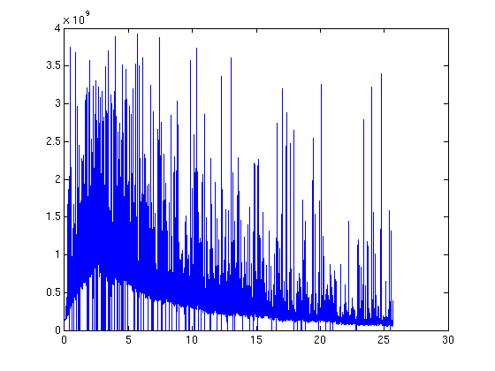

ok, in order to make you understand my issue, here's a Matlab sample code which reproduces my results :

As you can see, I am first computing the gravitational potential as a function of radius (the first figure). This is for getting an estimation of the potential with my data file "Positions_Disk.dat" which contains 3 columns (x,y,z coordinates of the stars) and 10240 lines.
After that, I solve the Poisson equation with discrete Fourier transform.
My problem is that I don't know if I have to add the factors space_x, space_y and space_z when I compute the discretized Green's function (
In all cases, I notice there's a big difference of values between the direct calculation of potential :
and the computation with fft :
You can see there is a difference on 10^3 between the 2 computations.
Anyone could help me to find which solution is valid ?
fab13 said:
Phi=Phi-G*mass/(abs(r(i)-sqrt(data(j,1)*data(j,1)+data(j,2)*data(j,2)+data(j,3)*data(j,3)))*kpc);
I don't understand that line. You calculate the distance of the star to the origin (the sqrt term), and subtract that distance from r(i)? That does not give the distance between two points. Also, what is that r(i)?
fab13 said:
For nice plot, delete spikes
Not surprising that you don't get larger values if you remove them manually.
r(i) corresponds to the distance between the origin and the point where I want to calculate the value of gravitational potential.
The gravitational potential at the point [tex]\vec{x_0}[/tex] of a collection of [tex]n[/tex] point objects of mass [tex]M_i[/tex] each located at a point [tex]\vec{x_i}[/tex] is: [tex]\begin{align} \Phi = \Sigma_{i=1}^{n} \frac{-GM_i}{|\vec{x_i}-\vec{x_0}|} \end{align}[/tex]
Which solution do you suggest ?
You calculate ##| |\vec{x_i}| - |\vec{x_0}| |##.
The subtraction has to be done with each component. sqrt( (r(i)_x - data(j,1))^2 + ... ) where (r(i)_x is the x-component of the (new) vector r(i).

I get with this script the following figure :
Unfortunately, I still have not the good values compared to the figure got with FFT computation, i.e this one :
As you can see on height coordinate, there is a 10^4 factor difference between the two figures.
How could I solve this problem of order of magnitude ? I should find similar values for the two computation.
Thanks
10^4 is the number of stars... some issue with the FFT normalization?
I don't think the issue comes from the FFT normalization because I use first a forward FFT and then a backward FFT.
I give you the Matlab sample code which achieves the solving by FFT :
Code:
