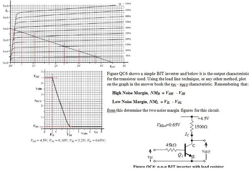

Hi I'm having some problems with using the graphical method to determine the output characteristics, the question and the answer are all included in the document attached. I understand the process of putting the load line on the graph but for this application i have no idea what to do.
Many thanks!

Here are some hints:
Since we are working in milliamps use resistors in kohms.
Vout = 4.5 - 1.5Ic
Vin = 45Ibase+0.65
So chose a series on Ibase and note where your load line intersects that value on the transistor characteristic curves graph.
Move across the graph horizontally from this intersection to read off the value of Ic corresponding to that value of Ibase
Substitute these pairs of values into the above equations to plot the Vout / Vin curve, as far as the noise limits given.
Does this help?
