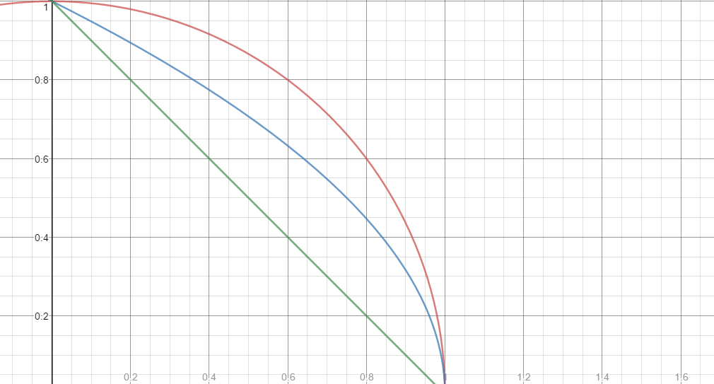

You are certainly right, but I was not looking for a simple formula. It seems odd that after a century, with all the supercomputers and specialized software available no one has yet bothered to plot the result into a graph for a rapid consultation?
In this graph I quickly made at desmos (thanks again for the link)
https://www.desmos.com/screenshot/tgdndqvsbu
you can see in blue the curve of the velocity addition, I was looking for a similar curve that shows the values according for GR. You can see clearly now what I meant when I said that they cannot be a lot different from the blue curve. Do you agree?
I have no idea. I barely understand the basics of relativity.
