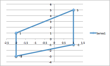

Wasn't sure of the best way to do this, but here you go :)

Oops I copied my work down incorrectly - ∫∫(2xy-2x)dxdy. I actually did integrate this function.
But I'm confused about what you're trying to say about my bounds. If I integrated from -2 to 1 in the x direction and -3 to 5 in the y direction, I would get a rectangle, wouldn't I? And this is not a rectangle.
And could you explain how my set up is incorrect (where did I go wrong?) and what the three parts of my integral would be? Thank you!

In setting up and evaluating the double integral in this case, one would integrate first w.r.t. y, and then w.r.t. x. Note that when integrating w.r.t. y, you can't use a single number for either the upper or lower limit of the integral; instead, the y limits are linear functions of x, specifically y = mx + b, where you must determine m and b for the two sloped lines at the top and bottom of the region. If you take the limits of y as being -3 and 5, you are implicitly assuming that the region of integration is a rectangle, which the plot shows is clearly not the case.
After the integral w.r.t. y is evaluated and the integral w.r.t. x is to be calculated, then the limits of x are from -2 to 1.

It looks like what LCKurtz is saying is that the bounds should be x from -2 to 1 and y from (2/3)x - 5/3 to (4/3)x + 11/3.
It should only get a little messy, since you will have quadratic terms as a result of the integration. Of course, you would have to integrate wrt y first. I would not recommend trying to integrate in x first, since you don't have the convenience of constant bounds in the y direction.

Ohh okay I see, I did that at first but it was such a pain. It's weird that my textbook gave me such a long, tedious problem. Thank you everyone!
