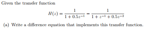

H(z) = (z2 + 0.5z - 0.5)/(z2 + 1.5z + 0.5)
The discussion focuses on the transfer function H(z) = (z² + 0.5z - 0.5)/(z² + 1.5z + 0.5) and its manipulation into a more manageable form. Participants confirm that the initial approach of multiplying fractions by z1 and z2 is correct, leading to the expression H(z) = 1/(1 + 0.5z⁻¹) - 1/(1 + z⁻¹ + 0.5z⁻²). The final step involves combining these fractions to derive a difference equation, which is essential for further analysis.

H(z) = Y(z)/X(z)
I realized this wasn't in partial fraction form because the 1+z-1+0.5z-2 has non-real roots. I multiplied the 1st fraction part by z1 and the 2nd fraction by z2, then I combined them into one fraction and I think I am able to get a difference equation at the end, but is the way I am doing it right? Or is there an easier way to do this problem that I am missing.
Yes, that's how you do it.
H(z) = 1/(1+0.5z-1) - 1/(1+z-1+0.5z-2) = z/(z+0.5) - z2/(z2+z+0.5).
Combine the fractions.
