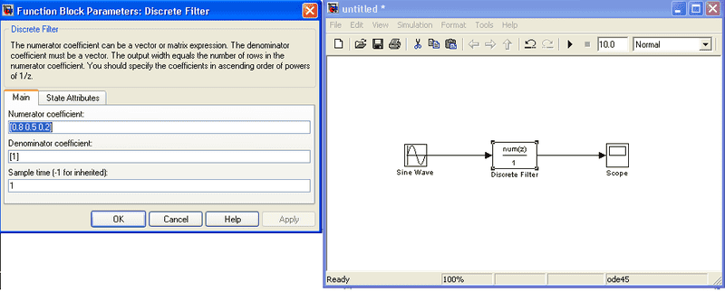

The problem statement essentially has me inputing a signal into simulink manipulating it and then looking at the output.
My output function is defined as $$y(n)=0.8x(n)+0.5x(n-1)+0.2x(n-2)$$
N/A
In my simulink canvas I have placed a sine wave as my source and a scope as the sink or output.
To implement this function i tried the block called discrete filter. I have connected them in series respectively.
When I open the parameters for the filter i have fields for numerator and denominator coefficients. So I took my Y(n) and calculated the z transform then found my H(z).
[itex]y(n)=0.8x(n)+0.5z^{-1}x(n)+0.2z^{-2}x(n)[/itex]
[itex]y(n)=x(n)(0.8+0.5z^{-1}+0.2z^{-2})[/itex]
[itex]H(z)=0.8+0.5z^{-1}+0.2z^{-2}[/itex]
So i put the coefficents into my filter parameters.
Numerator was [0.8 0.5 0.2]
Denominator was [1]
My input sine wave was left at the default of 1amplitude and 1 rad/sec.
My input and parameters:
Left: Function Block Parameters dialog for a Discrete Filter, Numerator coefficient [0.8 0.5 0.2], Denominator coefficient [1], Sample time 1. Right: Simulink model untitled with Sine Wave, Discrete Filter (num(z), 1) and Scope blocks connected in series.
This is what my output looks like.
Screenshot of a Simulink scope window showing a staircase-like yellow output trace on a black plot, with y-axis from -1.5 to 1.5 and x-axis from 0 to 10.
Am I on the right track here? I am not really sure what my expected outcome should be.
Thanks for any help.
  • Simulink Scope window titled Figures - Scope showing a yellow stepped output trace on a black plot, x-axis 0 to 10, y-axis -1.5 to 1.5, with values rising to about 1.15 near t=2 and dipping to about -1.1 near t=5.
  • Left: Simulink Function Block Parameters dialog for a Discrete Filter, Numerator coefficient 0.8 0.5 0.2, Denominator coefficient 1, Sample time 1. Right: Simulink model with Sine Wave block feeding Discrete Filter num(z)/1 block, then Scope.
Let's see...
So you have a sine input and a filter that does ##y(n)=0.8x(n)+0.5x(n-1)+0.2x(n-2)##.
The filter would take 3 consecutive values of the sine input and replace it by a weighted average.
What kind of output would you expect in such a case?
Can you say anything about the amplitude (since it's a weighted average)?
I guess I don't really understand how the weighted average would apply.
So the three consecutive values I assume are 0.8, 0.5 and 0.2? With 0.2 having the least weight? I would suspect that the amplitude would be decreased in certain areas. I am thinking that may not be the case since my output waveform had amplitudes that exceed 1? Of course I am not sure if that filter was implemented properly.
Suppose you have 3 consecutive values that are all close to the top of the sine, which is 1.
What would the value of the filter be?
Similarly, suppose you have 3 consecutive values that are all close to 0.
Finally, suppose you have 3 consecutive values close to the valley of the sine at value -1.
Im not sure that I completely follow.
3 consecutive values close to the top of the filter (1) I would guess the value of the filter to be close to 3?
For the values close to 0 i would guess it would be close to 0
For the values close to -1 following the same convention I would guess -3?
You have the filter y(n)=0.8x(n)+0.5x(n-1)+0.2x(n-2).
Suppose x(n)=x(n-1)=x(n-2)=1, what would y(n) be?
It would not be 3.
Well I would be left with just the coefficients right? So y(n)=1.5
Exactly. :)
The same would happen when the sine is around -1.
The resulting output would look like a sine, just like the input, with an amplitude that is more than 1, but less than 1.5.
Does your output graph look like that?
It certainly does! Its a bit blocky but that must be my sampling frequency in the simulation. I will have to play with it.
Thanks again for all of your help Ilse. Much appreciated!
