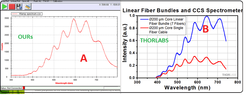

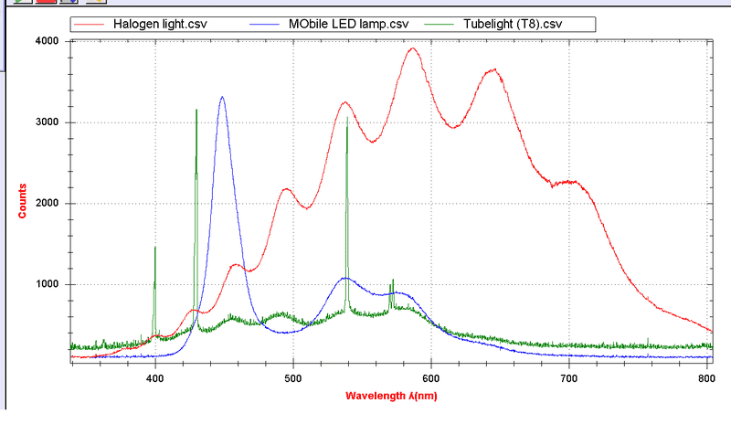

12V, 50W, MR16 halogen lamp spectrum is measured as shown ('B') with our newly developed mini-spectrometer having resolution ~1nm. But in internet it was similar to 'A' (We don't know how much resolution spectrometer they've used). Could anybody let me know what exactly the spectrum look like when measured with ~1nm resolution spectrometer (A or B) and why?
just check the below link for more understanding

It's a little hard to determine from just looking at the data provided. Suggestion would be to try measuring the spectral transmission curves ## \tau(\lambda) ## vs. ## \lambda ## of some optical filters by taking ## \tau(\lambda)=I(\lambda)_{source \, with \, filter}/I(\lambda)_{ source \, without \, filter} ## and comparing to the manufacturer's curves. If you get good results with that, it would demonstrate to some degree the quality of your spectral measurement apparatus.
Overlaying "OURS" and "OTHERS" images indicates someone is either compensating for optical fiber transmission when they shouldn't be or not compensating when they should be. Or maybe you got the sign of the correction wrong.
Interesting in any case. Please let us know what you find.

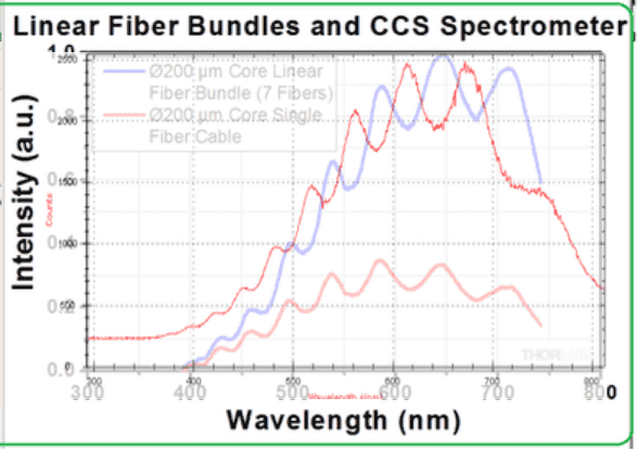

HI Tom!

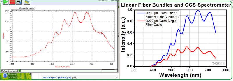

Thanks for the info. Following is more accurate image data for comparison.
The waviness pattern is exactly same, we felt that the performance of our spectrometer is matching to that of our competitor,
but in internet the spectrum would be something like the following.
I still didn't why is this waviness?
I inquired about it to concerned spectrometer manufacturer, they replied that it could be due to etalon effects caused by the glass window placed on to the linear CCD array. But the thing is we don't have any glass window on to the CCD array. I didn't understand what is that etalon effect.
Pls help.

The two plots you supplied for "OURS" in messages #1 and #3 are different. Message #1 shows a peak at 618nm but in message #3 it has shifted to 590nm. What changed?
You could ask the supplier of the "OTHER" plot what caused the ripples and if they are not real, can they be filtered out in software or removable with a calibration. I suspect the ripples are a common instrumentation artifact and published halogen lamp spectra have been corrected, probably automatically in the spectrometer.
Plot 'OURS' in message #3 is correct, pls ignore plot in #1 msg. I just calibrated the spectrometer.
I asked the 'OTHERS' i.e., Thorlabs, they just said it was due to etalon effects. I too feel it might not not be the reason. We are very sure that we are using CCD without glass window.
Pls check I'm just sharing the other spectra too.
Those graphs are so like what you get with a mismatched RF transmission line. The peaks would suggest that the standing wave is formed between two interfaces, separated by an order of magnitude of about a wavelength (?). That, presumably is your 'etalon effect'. The mismatch reflections are not too strong as the 'standing wave ratio' is only about 20%. I guess the situation could be improved by coating (blooming) each face. A cheaper solution would be to cancel out the variations of the data. numerically

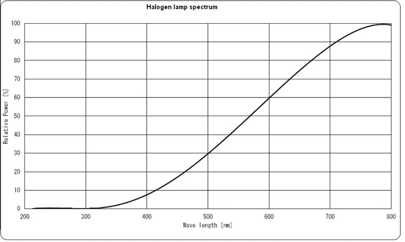

Why not use your spectrometer to examine a standard- for example, the sun? Or an incandescent bulb... Then you will know if your instrument has artifacts or not.

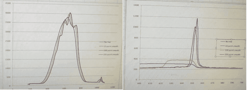

Following is are the spectra with different light sources.

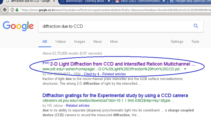

I found following paper pls have a look.

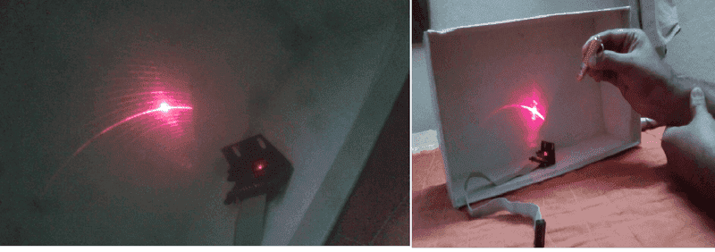

I just pointed the CCD surface with laser pointer and observed as below. (just for ur info)
This particular CCD have glass on its surface.
1) If I point the light on glass plate --pattern is not forming
2) Pattern is forming only, when I point light on to the pixels (CCD pixel size 8um, beam dia ~2-3mm)
3)Pattern is circular
4) Patten have fringes with increasing gap
From all the above I feel the the waviness is due to "diffraction caused by the CCD pixels randomly reflected/scattered into the spectrometer/detector section and that made this". But still need to confirm this, most importantly Solve this.

It looks like we are down to etalon effect somewhere in the optical chain and/or diffraction in the sensor. If it is in the sensor the only way I see to correct it is in a final calibration with the correction done in software. That would probably mean each a correction file included with each machine.
If the cause is etalon somewhere in the optical chain, then we are back to finding and eliminating the effect, or using a correction file as above.
