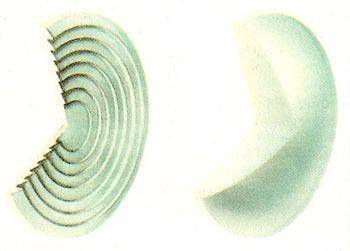

I admit I don't understand the "theoretically limitless" part, but here is another view of a Fresnel lens (on left) showing the concentric circular zones:
(From http://www.daviddarling.info/encyclopedia/F/AE_Fresnel_lens.html )
The text there may have the answer to the other question of the OP: "allowing mechanically robust lenses of relatively short focal length to be fitted " - thus for big lenses a short focal length implies a weight problem, because they are thicker. The Fresnel lens does not have that drawback.

Here you are describing zone plate lenses which are base on diffraction,the OP, however, was enquiring about Fresnel lenses which are based on refraction.The diagram posted by Redbelly shows such a lens in cross section and you will see that there is a smoothly varying convex section in the middle surrounded by a finite number of prismatic sections whose angles increase from the centre outwards.
Agreed, a Fresnel zone plate is different than a Fresnel lens, in just the way Dadface describes.
