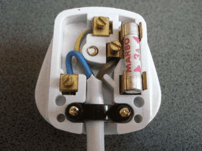

When used as intended, the internal fuse protects against excessive current through the individual plug, whatever the cause. This current can be well within the capacity of the ring main.Nidum said:View attachment 205713
This is the inside of the 3 pin plug used on most domestic and office equipment in the UK . Rated at 13 Amp but generally used on devices drawing up to about 10 Amp maximum . Various rated fuses can be fitted . Most common are 3 Amp and 13 Amp .
Problems can arise when the fuse is replaced with other objects, such as foil, nails or, in at least one case discovered, a live .22 bullet!

The great shame is that replacement 13A plugs seem to arrive with 13A fuses in them. If they were supplied with 2 or 3A fuses then the majority of equipment would work fine. It would be put to the purchaser to have a supply of higher current fuses for beefier equipment. There are arguments against this, based on convenience but it would have been a good idea to start that way.darth boozer said:When used as intended, the internal fuse protects against excessive current through the individual plug, whatever the cause. This current can be well within the capacity of the ring main.
But nowadays, most appliances are supplied with moulded plugs on their leads and people mostly don't get involved with wiring plugs at all. The original fuse on a plug that's moulded on an appliance will be the right one. It may not be green practice but a faulty appliance is indication to buy a new one, these days.
