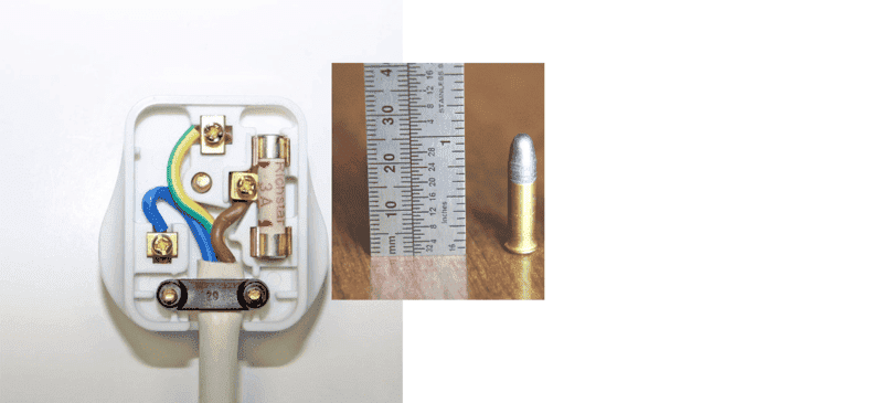

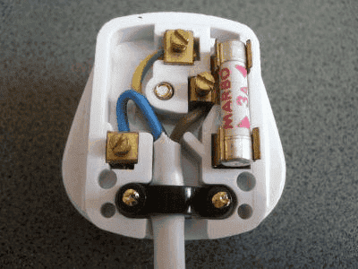

This is the inside of the 3 pin plug used on most domestic and office equipment in the UK . Rated at 13 Amp but generally used on devices drawing up to about 10 Amp maximum . Various rated fuses can be fitted . Most common are 3 Amp and 13 Amp .
So what risks do those fuses protect against?. Presumably, a short circuit will blow the fuse or breaker on the house's panel. Is it overload of the appliance, but not short circuit?

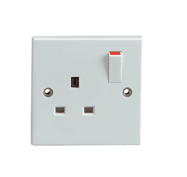

The standard 13A plug was designed in conjunction with the (240V) Ring Main system, which has a 32A fuse, feeding several outlets (at least five or six twin outlets). A fault in an appliance or even a partial short at the cable entry can produce a load which will not blow a 32A fuse but fry the lead and set fire to the carpet etc. There are many differing opinions about 120V vs 240V domestic systems but the higher voltage allows thinner conductors and more flexible leads for appliances. That's a real practical advantage. A plug fuse gives the appropriate protection for the appliance and its lead where the fuse at the panel has to be over-generous for low power appliances.
People who aren't used to the Ring Main tend to treat the whole idea with suspicion and fear. Nonetheless, it works very well and there are very few accidents which can be attributed to that system. It's even better nowadays when all appliances are fitted with moulded plugs and the correct fuse. People do very few home repairs these days and appliances mostly get thrown out with the original fuse still in the plug.
Also, Ring Main = Low Cost Installation.
@ Anorlunda : So what risks do those fuses protect against ?
The primary purpose of a fuse is to protect the electricity supply system from any damage which could be caused by excess current flow due to a short .
Basic theory is that fuses are always arranged so that in event of a short in one section of the supply system they prevent any excess current from being drawn from the next section along in the direction of the power station .
In the standard UK electricity supply system there is a cascade of protection devices of increasing rating between your domestic appliance and the power station .
Actual blow wire fuses are only used in the lower power end of the system . Solenoid and electronic breakers are almost universally used at higher powers .
New build houses in UK now mostly have electronic combined RCD + overload protection systems .
Nice little link with history though - most power supply companies still demand the fitting of a 100 Amp cartridge fuse on the ingoing feeder . They never seem to blow . You still see ones in use that are over 60 years old and with the trade name markings of long gone makers .

This type of wall socket is the one used almost universally with the ring mains that @sophiecentaur described above . The plug goes with the socket . There are other types of plug and socket but they are rarely used now .

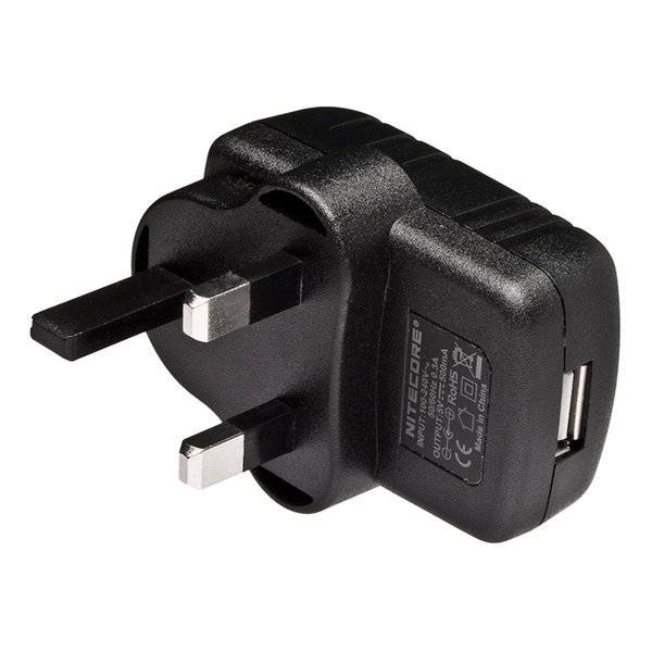

What about minor appliances like a cell phone charger, or a LED night light?
View attachment 205746View attachment 205745
They are autonomous and, if they are type approved, then they will have their own internal protection. ("No user serviceable parts inside" - but I have tried on occasions) I think the lower picture is of a US socket?. The very low power devices catch fire relatively often, I believe. eBay -type imports could have absolutely anything inside them - even just a high value resistor and a diode and the authorities can't really do anything about that.
There are no Outlets on a ring main that do not include a fuse - ' a fused spur' has the fuse integral and a fixed cable, feeding a permanent appliance or possible an alternative non-fused plug. The standard 13A plug is a big beast and it takes up a lot of wall space. That's the only downside of it I can think of. It is possible to feed a compact distribution panel from a fused spur on the ring. Nerdy hifi and computer types will use such a system in a 'home studio' environment where there are dozens of bits of low power equipment. But the easier alternative is to use a multiway extension.

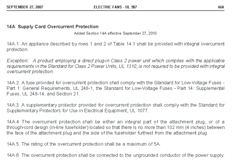

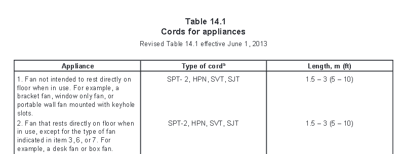

These fused power cords are new to me. I've seen GFCI's built into hair dryers and room airconditioner cords, didnt give them much thought.
The references to a 'new' UL standard 507 for American cords suggests a requirement i didn't know about. Sounds like they're extending overcurrent protection out into the small appliances.found it, http://files.instrument.com.cn/bbs/upfile/files/20100806/201086123527.pdf
page 40A (71 of pdf)
and page 46A (79 of pdf)

Once again, @jim hardy does the best Internet research finding that UL (Underwriters Laboratories) report.
It says that the overcurrent protection requirement was added in 2010. But I bought a box fan in 2016 that had no such protection. Does that mean not UL approved? It is not clear to me when UL compliance is required.
