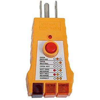

Maybe also get one of the electrical socket testers and see if the sensitivity level of the Lowe's receptacle is the same as your in-house GFCI. Maybe the in-house one is less sensitive, and the pressure washer did have a slight path to ground that tripped the more sensitive GFCIs...
https://images-na.ssl-images-amazon.com/images/I/41xgYJ1keXL._SL500_AC_SS350_.jpg

I'm also going to take @berkeman's suggestion and get a receptacle tester.
