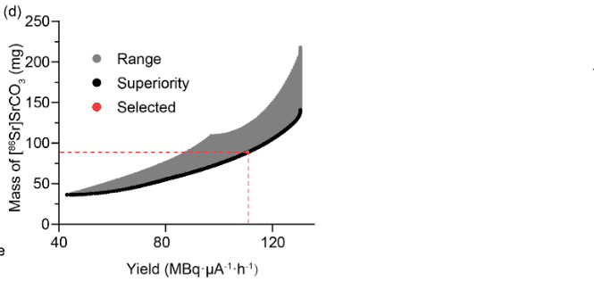

I'm trying to find the required target mass for a specific nuclear reaction with a fixed yield and cross-section.
I am trying to get a plot, or a result for target like this:
Scatter plot of mass of [86Sr]SrCO3 in mg against yield in MBq·µA⁻¹·h⁻¹, showing a grey Range band, a black Superiority curve and a red Selected dashed guide line.

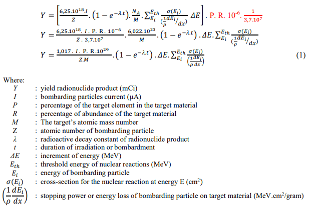

I've found some equations for my requested results, but they are from the same person's articles and I couldn't find another source. I've searched for EOB and TTY calculations but couldn't really do something. Could you give me an easy equation to apply? Also there are equations from this link:
https://www.degruyter.com/document/doi/10.1515/ract-2013-2234/html
Printed text defining the Cu-64 radioactivity yield Y and equation (1): Y = mcN_A σ_T φ / A_T (1 − e^(−λt)), with variables m, c, N_A, σ_T, A_T, λ and t described.
Equation block with three versions of a radionuclide yield formula Y, numbered (1), followed by a list defining the symbols Y, I, P, R, M, Z, λ, t, ΔE, Eth, Ei, σ(Ei) and stopping power.
Could you help me with the wanted results? What equation should I use?

All parameters in your equation are constants or given except the time, the mass and the beam flux (calculate the decay constant from the half life). The flux you have to find somewhere. For the best rate (minimal target mass) you would assume "infinite irradiation time" (##t\gg\lambda##). That is not realistic with a half life of 59 years, so choose some realistic irradiation time.
@mfb I do not have the flux. And I want to get mass results for 29.4TBq/μA.h, just like the graph on top. But I do not have the equation. Are those real equations that give me mass or should I use another TTY equation?
I actually want something optimal, an optimal mass with an optimal time but to get there I think at first I need the mass information for 1 hour irradiation at 1 μA for the required activity yield. Also is there some way to transform beam current to the beam flux?
Then divide the equation by the flux and the time.
