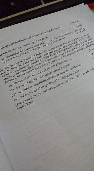

Question C(ii)
Photo of a printed exam question on heat conduction through a non-metallic solid, covering the thermal conductivity definition and a brick and plaster wall calculation with parts (i) to (iv).

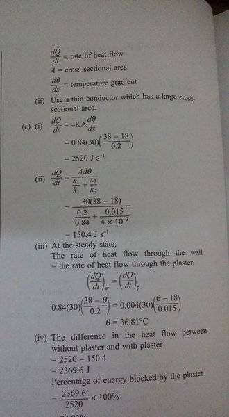

Handwritten worked solution to a heat conduction problem: dQ/dt = -KA(dθ/dx) with 0.84(30)((38-18)/0.2) = 2520 J/s, then dQ/dt = AΔθ/(x1/k1 + x2/k2) = 150.4 J/s, steady-state equation, and percentage of energy blocked by the plaster.
dQ/dt =-kA(dθ/dx)
dQ/dt = (θ1-θ2)/ ((lx/kxAx)+ (ly/kyAy))
So the first time I tried at this question, I was using the second equation provided above,but when I check the answer, they put the area on the numerator. which left me wonder, how did they make it on top, I've check my textbook but none of it give any clues. If area is on the numerator with θ, I think k should be too isn't it?
  • Photo of a printed exam question on heat conduction through a non-metallic solid, covering the thermal conductivity definition and a brick and plaster wall calculation with parts (i) to (iv).

  • Handwritten worked solution to a heat conduction problem: dQ/dt = -KA(dθ/dx) with 0.84(30)((38-18)/0.2) = 2520 J/s, then dQ/dt = AΔθ/(x1/k1 + x2/k2) = 150.4 J/s, steady-state equation, and percentage of energy blocked by the plaster.

If Ax = Ay = A, you can multiply numerator and denominator by A, so A will appear in the numerator and not the denominator. You can do the same with k if kx = ky, but that is not the case in this problem.
I see, thanks for your answer
