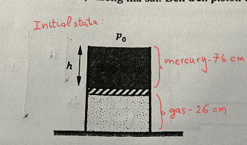

A vertical cylinder contains a definite amount of ideal gas, sealed on top with a massless and frictionless piston. On top of the piston there is a mercury column of height h = 76cm. Let atmospheric pressure be p0 = 100000 N/m2, cross-section area of piston is S = 20cm2, initially the piston is 26 cm above the bottom of the cylinder. We then heat the gas so that it expands and push all of the mercury out of the cylinder. Calculate the amount of work done by the gas from the beginning until all of the mercury has been pushed out.

Sorry, I forgot to supply the diagram:
I think I should add that the cylinder-piston system is insulated and heat is supplied from within the chamber.

There is no 'hottest temperature' (unless you haven't given us the full question?). You can make the gas as hot as you like. As the gas temperature increases, its volume increases. You can push all the mercury out by making the gas hot enough.
You are asked to “calculate the amount of work done by the gas from the beginning until all of the mercury has been pushed out”.
Think about what the work actually does. From conservation of energy, we know that the work done by the gas will be the sum of:
a) the gravitational potential energy gained by the mercury;
b) the energy needed to ‘push back’ the atmosphere to make space for the increased gas volume.
(We’re assuming the process is slow enough so that the amount of kinetic energy gained by the mercury is negligible.)
We need to calculate and add a) and b). Job done. Exactly how the gas is heated is irrelevant.

I agree, maybe I was just complicating the problems from the start by adding those phases and hottest temp. Thank you all a lot.
