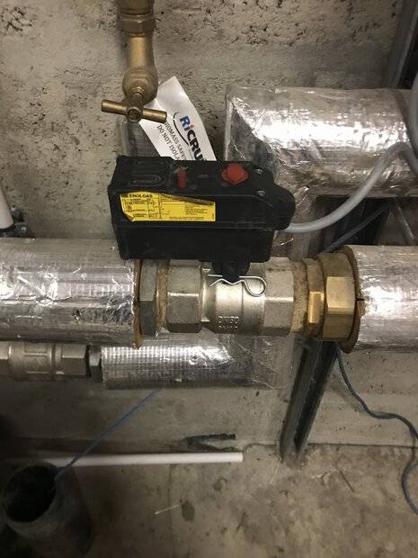

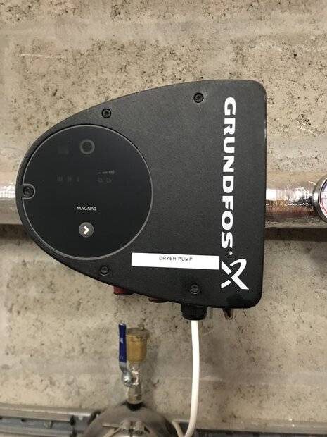

A microswitch in a heating valve keeps sticking shut. Is this due to low quality, thermal stress, inappropriate rating, or something else?
Here is the valve in question, an Enolgas R2835P00:
Photo of a brass ball valve on an insulated pipe, with a black microswitch housing mounted on top of its actuator and a yellow warning label on the switch.
The default state is shut, as shown by the red indicator in the picture, oriented crossways. When activated, either by the frost ‘stat, or the user, the valve opens 90deg, and at the end of travel, switches on a pump:
Photo of a Grundfos MAGNA1 circulation pump mounted on a textured wall, labelled DRYER PUMP on a white sticker, with a ball valve and white cable below it and pipework to the right.
Rating plate:
Close-up photo of a black pump rating plate reading MAGNA1 50-100 F 280, 1x230V 50/60Hz, with P/N, S/N, IP X4D, TF 110, EEI 0.21, power ratings 0.22 to 1.90 A and 20.91 to 425 W, 1.0 MPa, Made in Germany, and CE and EAC marks, plus a QR code.
The recurring fault, (this is the third valve in 6 years), is that the microswitch (SPDT) sticks shut, such that, on activation, the valve doesn’t open, but the pump is switched on, resulting in its pumping against a shut valve.

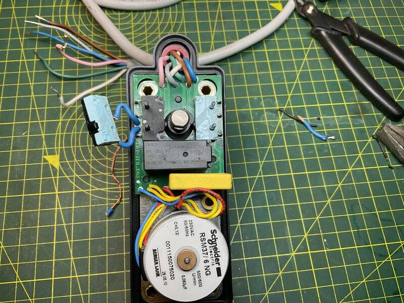

Here are the internals:
Photo of an opened Enolgas valve actuator on a cutting mat, showing a green circuit board, a microswitch at the upper left with blue and other coloured wires, a Schneider motor labelled RSM37/6 NG, and loose wires and pliers beside it.
The offending switch is top left (normally situated underneath the switch with blue wires, which has been pulled to the side). You can see how it’s activated by the cam, once the shaft has rotated 90deg anticlockwise.
The switch is made by Crouzet, MPN: 83170012. SPDT. Rated 10A.
I have, in the past, squirted switch cleaner/lubricant (Servisol) into the switch, and worked it. This solves the problem for a variable time, but it still recurs.
What could be the problem? I thought perhaps the grease inside the switch was drying out (valve is generally lukewarm for most of its time), but the latest application of Servisol only lasted a few days. I think the switch contacts are welding together. They shouldn’t, assuming Crouzet is a decent brand, and that the switch is correctly rated, which it seems to be.

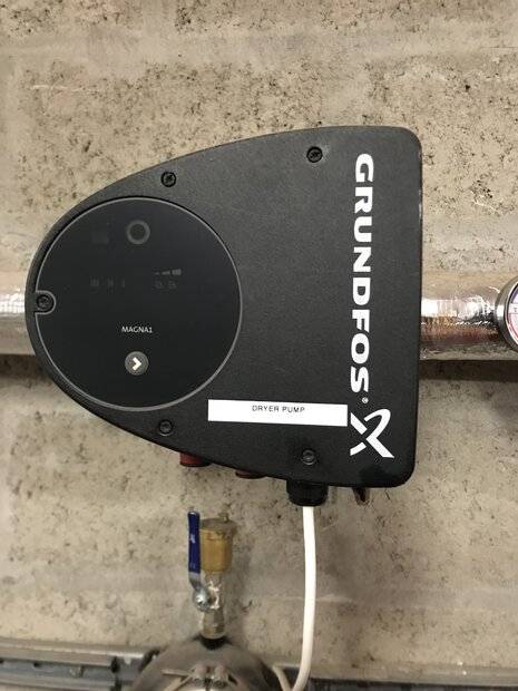

Although the pump power rating is well inside the 10A capability of the switch, it is an inductive load, so this may be a factor.
It is a snap action switch with an 0.35 mm gap.
https://au.mouser.com/datasheet/2/92/SW_MS_SM_V4_83170_EN-2886939.pdf
I think the inductive load details are important here.
Examining the curves in the data sheet predicts a life of 30,000 cycles at 10 amps for an inductive load. Those 30k cycles would be consumed in 2 years, if there were an average of 42 cycles per day.

So I’m on my own a bit. Am I looking for a relay with ac switching power of at least the 425W peak listed on the pump? I wasn’t aware that switching current and switching power could be different things.
The normally open contacts of the relay in Post #7, as can be seen on the label specifications, are rated for up to a 1/2 hp (0.37 kW) motor at either 120 or 240 volts AC. A motor is a motor whether it drives blower or a pump. It is always best if the relay rating is larger than the load. The relay in Post #7 is driving a 1/15 hp blower.
If your pump is rated at 0.425 kW, that would be 0.6 hp. This relay would be too small for such a load. If that 0.425 kW is just the inrush current at pump start, then the actual motor power would be less. A photo of the pump data plate would help us.

It’s looking like that little microswitch is nowhere near enough for what it’s switching. The actuator is intended for switching a pump, but perhaps not one as large as this.
Pump data plate is third photo in post #1.
You are fighting two problems here trying to control a motor with a low power switch.
1) The Inrush Current to the motor when power is first applied and the motor has not yet starting turning. Rule-of-Thumb is the Inrush, or Starting current, is 10 times the full load rating. (Larger motors will have rating on their nameplate called Locked Rotor Currrent (or LR Current) that will be more accurate than the factor of 10 above.)
2) The Inductive Kick when power is removed from the motor. The collapsing magnetic field in the motor can create a voltage several times the line voltage. I don't have a Rule-of-Thumb for this.
For 1), the high current starts: At the instant of turn-on, the switch contacts are just slightly touching and not making good contact with each other. This relatively high resistance and the high current rapidly heats the contacts for a fraction of a second at each turn-on. The high temperature causes oxidation of the contacts and even higher resistance... and more heat, the next time.
For 2), the Inductive Kick: The high voltage from power removal causes arcing across the contacts. The arcing erodes the metal contact surface causing pits and often high spots or spikes on the mating surfaces, greatly increasing the contact reistance and heating at the next switch closing.
The two factors above working together will eventually cause switch failure, either by welding the contacts closed upon starting, or burning them enough that they will not make electrical contact at all.

@Tom.G Thanks for the advice. I‘ve actually set up quite a few machines with new motors, DOL starters with contactors/overload, VFDs, etc.
The contactors are, being designed with motors in mind, quite easy to specify: FLA on the motor plate, or kW rating, plus some headroom.
What has foxed me here, going to a smaller relay, is that the current rating is more nuanced and specific to circumstances. I was hoping to pick up a standard 240V, 10A+ relay which should do the job, but have found that they are significantly derated for inductive loads.
I’ve found a 20A relay, that will switch *only* a 550W inductive load, so will try that.

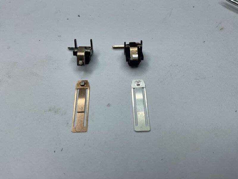

Right, I’ve installed the relay and replaced the microswitch. You can clearly see the deterioration of the old contact vs the new:
Two small microswitch assemblies in black plastic housings with metal contact arms, shown above two flat metal contact strips, one copper-coloured and one silver, each with a small contact point.
