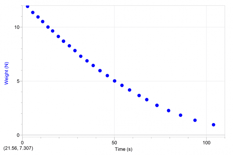

Hi guys,
I was just doing an experiment with relating the weight flow rate of water out of cylinder with a pin hole at the bottom. The equation that I put together was: $$\dot{W}=\rho g C_d A \sqrt{2gh}$$ ##\dot{W}## is the weight flow rate, ##\rho## is the density of water, ##g## is the acceleration due to gravity, ##C_d## is the coefficient of discharge of the orifice, ##A## is the area of the orifice, ##h## is the height of the water above the hole. The problem that I am facing is that the weight flow rate changes with time along with the height of the water. Thus, I thought that if I can find an equation for the height as it relates to time, I can plug it into the equation above, and my equation would be complete. I also need to see how you got to whatever equation makes sense. I am looking for something like: ##h = kt##. As in k can be any function including any variables that make sense. I believe this requires derivatives and integrals so don't be afraid to include and explain them.
Thank you very much for your help.
Jonathan
If ##A_x## is the cross sectional area of the tank and h(t) is the height of liquid in the tank, what is the weight of liquid in the tank at any time?
The weight of the water in the bottle changes in relation to time. At 11.06 seconds, it is 10.51481546 N, at 46.18 seconds, it is 5.507255163 N. The ##A## in the equation above is the area of the hole. I was hoping to include the ##A_x## in the height-time equation. This is what Wikipedia gave:

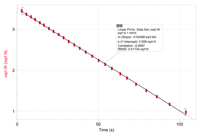

Well, I guess I'll have to answer my own question.
$$W=\rho g A_xh$$So,$$\frac{dW}{dt}=\rho g A_x\frac{dh}{dt}=-\rho g C_DA\sqrt{2gh}$$
This gives me:$$\frac{dh}{dt}=-\frac{A}{A_x}C_D\sqrt{2gh}$$
Do you know how to solve this equation for h as a function of t, subject to the initial condition h = h0 at t = 0?

Suppose I rewrote the equation as $$h^{-1/2}dh=-\frac{A}{A_x}C_D\sqrt{2g}dt$$
Could you integrate each side of the equation then, at least as an indefinite integral (i.e., with an arbitrary constant)?
Would this be:
$$\int \frac{dh}{\sqrt{h}} =\int -\frac{A}{A_x}C_D\sqrt{2g}dt$$ By factoring constants:
$$\int \frac{dh}{\sqrt{h}} = -\frac{A}{A_x}C_D\sqrt{2g}\int dt$$ Solving:
$$ 2\sqrt{h} = -\frac{A}{A_x}C_Dt\sqrt{2g}$$ Solving for h:
$$ h = \frac{2gt^2A^2C_D^2}{4A_x^2}$$
Did I do this correctly?

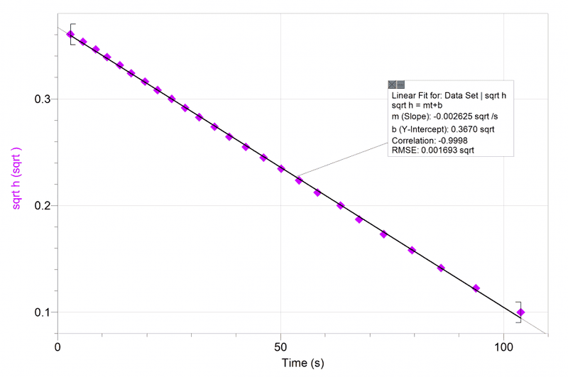

Not quite. You left out the constant of integration:
$$ 2\sqrt{h} = -\frac{A}{A_x}C_Dt\sqrt{2g}+C$$
To determine the constant of integration, you need to substitute the initial condition into this equation. What do you get for C? When you substitute this back into the equation for arbitrary h, what do you get then?
When ##h = h_0##, ##t = 0##, and ##h_0 = 0.14## m, I get ##C = 2\sqrt{0.14}## or ##\frac{\sqrt{14}}{5}## or ##0.7483314774##
This is correct, but I has hoping that you would substitute ##C=2\sqrt{h_0}## algebraically into the equation for h, and then solve for h. Alternately, you could leave the equation in terms of ##\sqrt {h}##. This would show that ##\sqrt {h}## is a linear function of t, with an initial value of ##\sqrt {h_0}##. What would you get if you plotted your data on a graph of ##\sqrt {h}## versus t? What would be the slope and what would be the intercept? What would you get if you plotted ##\sqrt{W}## vs t?
With time on the x-axis and the ##\sqrt{h}## on the y-axis, I get the slope to be ##-0.002625## and the intercept is ##0.3670##. The correlation is -0.9998.
Excellent. Now the slope should be equal to some combination of the parameters in your model. Algebraically, from your final equation, what is the slope equal to? If you know the pinhole area, you should be able to use the slope of your graph to determine the discharge coefficient.

##A = 0.0000001781393481## ##m^2## (area of the pin hole)
##A_x=0.0094717086## ##m^2## (cross sectional area of the cylinder)
##g = 9.81## ##ms^-2##
##C=\frac{\sqrt{14}}{5}##
##m = -0.002625## (slope of the graph)
$$C_D=\frac{m-C}{-\frac{A}{A_x}\sqrt{2g}}$$

How accurate is the pin hole area?
I used a ##\frac{3}{16}## inch diameter drillbit.
For a 3/16" hole, 1 get 100 x your area.
True, you are right, the coefficient that I get is 0.315, thank you very much.

Not so fast. That's still pretty far off. Is there a factor of ##\pi## missing somewhere?
Well the cross sectional area of the tank is:
$$A = \frac{C^2}{4\pi}$$
$$A = \frac{0.345^2}{4\pi}$$
$$A = 0.0094717086\ m^2$$
The area of the hole:
$$A = \frac{\pi d^2}{4}$$
$$A = \frac{\pi 0.0047625^2}{4}$$
$$A = 0.00001781393481\ m^2$$
I'm not sure where the extra ##\pi## disappeared...

You're missing a factor of 2 in your equation for the slope. It should be :
$$C_D=\frac{2m}{-\frac{A}{A_x}\sqrt{2g}}$$
Can you see where the factor of 2 comes from?
I'm guessing it's because I'm plotting time against the square root of the height... but it still only gives me 0.63 if the 2 is negative. Does 0.63 as the coefficient of discharge make sense because the hole that I made isn't exactly perfect?
The 2 isn't negative; the slope is negative. It seems like the value of 0.63 is, for whatever reason, the correct Cd for your system.
As far as the factor of 2 is concerned, rewrite your equation in terms of ##\sqrt{h}## rather than ##2\sqrt{h}##, and back out what the slope should be.
