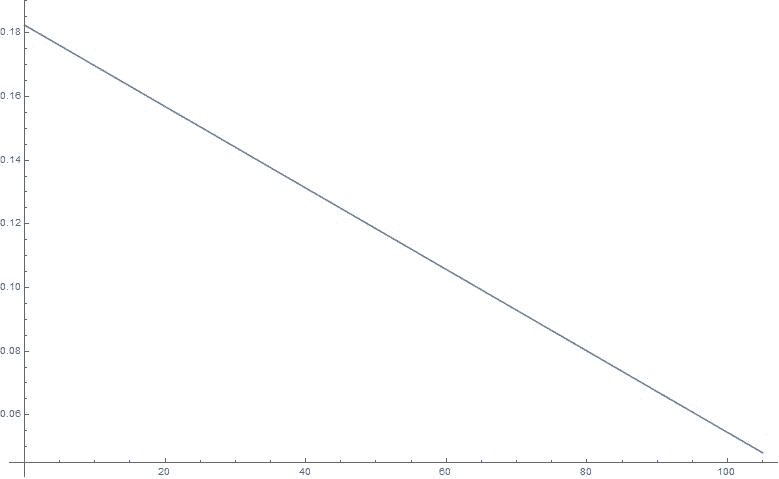

Right that makes sense, I'm not sure why I mind-blanked there. I forgot I was factoring ##\sqrt{h_0}## and not ##h_0##. So now I can plug it into the first equation to get: $$\dot{W} =\rho g C_DA\sqrt{2gh_0}-\frac{t\rho g^2 C_D^2 A^2}{A_x}$$
$$ \dot{W} = \rho g C_DA\left(\sqrt{2gh_0}-\frac{tgC_DA}{A_x}\right)$$
Is this correct?
  • #42
Is this correct?
I think so, but not the first version.

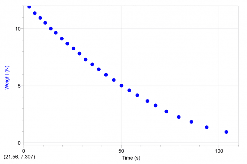

The second equation was just a factored version of the first one... is there any way of verifying that this equation makes sense? Here is the graph for weight to time:
  • #44
This is not the rate at which the weight is leaving, right? It is the weight itself vs time, right? If ##\sqrt{h}## vs time is a straight line, and W is proportional to h, then, if you plot ##\sqrt{W}## vs time, that should be a straight line also. Plot it up and see.

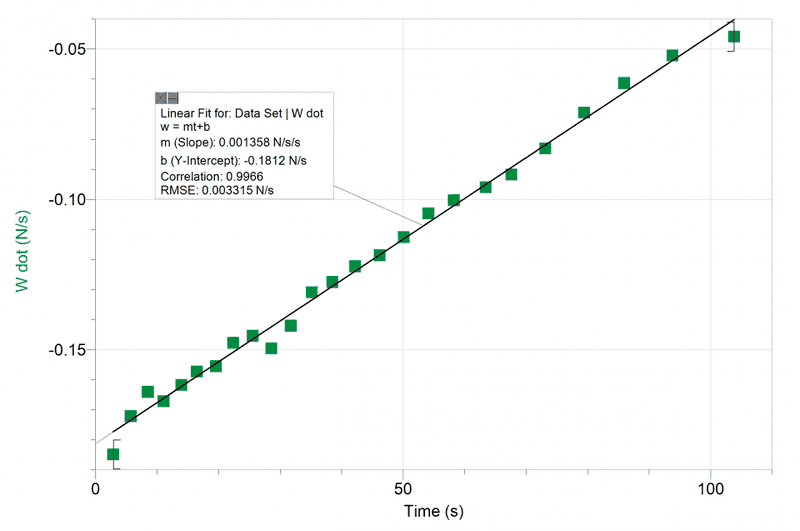

I am using a software from Vernier called Logger Pro, I used it to take the numerical derivative of the weight vales and plotted it against time. If my formula above is correct, then ##\dot{W} \propto t##. This is what it came up with:
However, the derivative values that it came up with were all much smaller than what I calculated by inputting time values into my formula. For example, at 8.52 seconds, I got the flow rate to be -0.907... but the software gave me -0.164 and at 38.5 seconds I got -0.3197... but the software got -0.128. Why is this the case, is it because my equation is wrong or is it because the software had no definite formula to get the derivative of and just used data points?
  • #47
I'm having trouble following exactly what you did.

The derivatives that you calculated by hand seem way out of line with the graph of weight vs time. Did you remember to divide by ##\Delta t##?
  • #50
Why would I need to divide by time. I just plugged in the parameters and values into my equation above. If I did divide by time I would get ##-0.10655...## and ##-0.008305...# respectively for 8.52 seconds and 38.5 seconds.
  • #51
I didn't calculate the derivative by hand, I just made Logger Pro do a numerical derivative from the data given with respect to time. I tried to verify it by using my formula and plugging in values.
  • #52
In any case, what does a negative flow rate mean? Do you just take the absolute value of it because clearly the slope of the tangent of the graph in post #43 is negative.
  • #53
The finite difference approximation to the dW/dt is ##\Delta W/\Delta t##. I didn't say to divide by time. I said to divide by the time interval between the point A and point B. The graph of W dot vs time made by Logger Pro looks consistent with the graph of W vs time to me.

Yah, the weight is decreasing, but how do I divide my formula by the time interval? Can you show me please an example with my data of how to get the same answer that Logger Pro is getting?
  • #56
Give me the weights and times at two points, A and B.
  • #57
Point A: 9.131339746N at 19.58 seconds
Point B: 3.281800887 N at 67.6 seconds
  • #58
$$\frac{\Delta W}{\Delta t}=\frac{3.2818-9.1313}{67.6-19.58}=-0.122$$
This is over a rather large time interval, so we need to associate this value of dW/dt with the average value of time over the time interval (19.58+67.6)/2=43.6 sec. See where the point (43.6, -0.122) would fall on the Logger Pro graph
