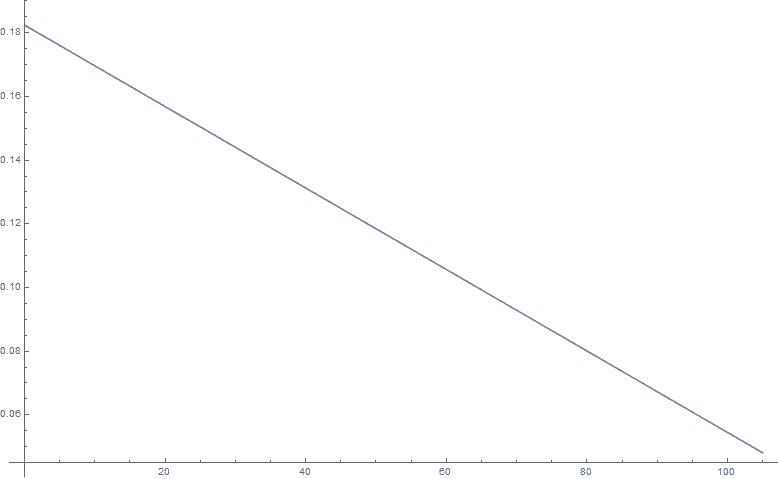

  • #61
The one that we've been trying to figure out:
$$\dot{W} = \rho g C_D A \left(\sqrt{2gh_0}-\frac{t g C_D A}{A_x}\right)$$
When would I have to use this?
  • #62
Shouldn't that also have given -1.22 if I plug in 43.6 seconds or 48.02 seconds (I don't know which one to use, the average or the ##\Delta t##)?
  • #63
Now that you know the value of Cd, you can plot this equation up and see what you get. Plot a graph of this equation so that we can compare it with the Logger Pro graph for dW/dt.
  • #64
You calculate the derivative from the difference in the times, but you plot the derivative at the average of the times. It is just a coincidence that the difference and the average are about the same value for this particular case.
  • #65
The weight flow rate against time. Sorry for the lack of labels, I did it in Mathematica and don't know how to add labels
  • #66
Excellent. This is almost the exact negative of dW/dt calculated by Logger Pro from the raw data.
So you can see that, once you have determined Cd, you don't need the data any more.
  • #67
Thank you very, very much, I really appreciate your help. The equation works and very happy that I understand how I got it. I really am very thankful for your help. I struggled to make sense of it all for an entire week with my math and physics teachers at school. Thanks again,
Kind regards,
Jonathan
