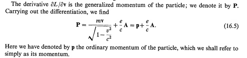

Thanks. Landau, classical thery of field says
sign of A is different from Sakurai and Napolitano. It is due to conventions they refer or I take wrong correspondence of P,p in Landuau and ##\Pi##, p in Sakurai ?
Again the canonical momentum is ##\mathbf P=m\mathbf v +q\mathbf A=\boldsymbol \Pi+q\mathbf A##, where ##\boldsymbol \Pi## is the ordinary momentum. All the books are consistent unless the charge is taken as negative for electrons.
