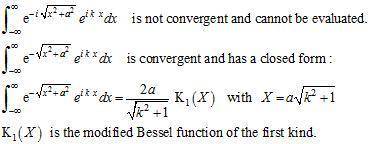

Hello everyone,
I'm having trouble understanding how to evaluate this integral. I am not sure whether there is a closed form solution.
[itex]\int_{-\infty}^\infty e^{-j\sqrt{x^2+a^2}} e^{-jkx} dx[/itex]
I am trying to express a polar wave as a summation of plane waves, and this integral drops out when solving for the amplitudes of the plane waves. Thanks very much for your help. A link to a reference, or the necessary techniques would be very helpful.
-Patrick
Hi !
Did you first check if the integral is convergent or not ?
If not, are you sure that the given integral has a physical meaning ?
(I think that the integral is not convergent).
A typo in your integral ?
