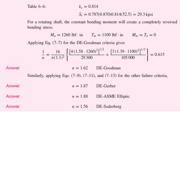

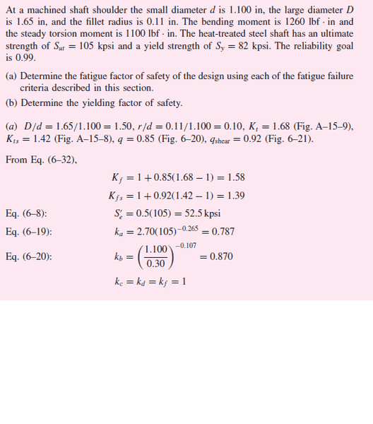

thanks for your replyNo it's not for cheating, it's an assignment >>>
its not static page at all,,, this page is used to solve the examples in a book but the inputs are differ ,, there is an example in the attachments;
for this example the diameter of the shaft may differs or the bending moment ..etc
also this example uses a table to get information due to the data given...If I use MATLAB its difficult to put it in an HTML page...//
