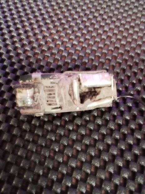

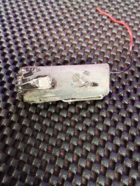

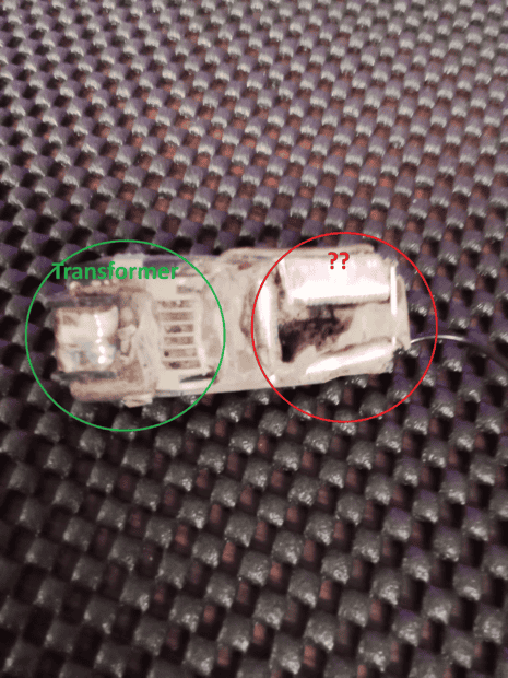

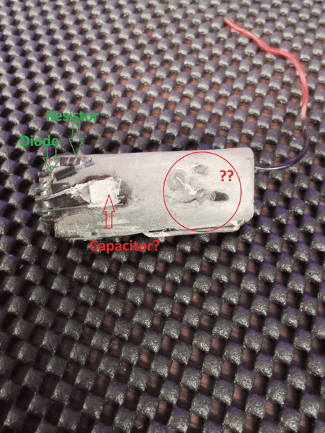

Hi, I recently acquired some of these cheap modules for plasma experiments. I tried dissolving the epoxy off of one of them in an attempt to reverse engineer the circuit. I can see a resistor, diode, and transformer but am unsure about some of the other components. I was wondering if anyone here could just look at some of these parts and help identify them, or give some insight into what is going on with the circuit.

So, these are possibly switch mode power supplies? Is anything identifiable from the pictures? I can try to remove more epoxy, but its a little fragile.
I would not call them that. Just some kind of self-oscillating boost circuit without any regulation or filtering.
If you terminate the current on a coil fast enough you can make some really high voltages without any need to have serious HV circuitry.
