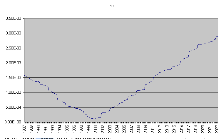

Earth's inclination is not fixed. Like the other planets, its inclination changes. The j2000.0 epoch will define the ecliptical plane as the inclination of the Earth/Moon barycenter on January 1, 2000 at noon. Here's a graph I made with Gravity Simulator showing the inclination of the Earth for a few decades surrounding 2000. Note that it doesn't completely zero-out at j2000. My guesses are that this graph is Earth's instantaneous inclination, rather than the inclination of the EM barycenter. And it's the inclination with respect to the Sun rather than with respect to the SS barycenter. But those are just my guesses.
If inclination is exactly 0, longitude of ascending node is undefined. I believe that in this instance, it's specifically defined as the vernal equinox. In the real universe, there's no such thing as an inclination of exactly 0, except for the instantaneous moment when you define the plane. As the graph shows, it immediately drifts.
"Longitude" means degrees from the vernal equinox. "Argument" means degrees away from the longitude of longitude of ascending node.

Thats my point, these data are for the exact same moment as when the J2000 plane is defined, and they are both "mean" values.
So if there is an inclination at this time, what is the plane its inclined to?
Interesting graph, if your guesses are right, then over these few decades the average inclination of the Earth is always greater than its mean!
