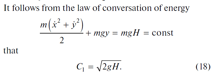

I am currently reading this paper (https://www.researchgate.net/publication/373607009_Exact_Solution_of_the_Problem_of_Brachistochrone_with_Allowance_for_the_Coulomb_Friction_Forces), where the author models the brachistochrone (least time of descent) curve for a circular ball while considering coulomb friction.
I'm confused by the penultimate step (the working behind equation 18).
.5mv^2 + mgy = mgH
Others contained in file / attached in attempt
Conservation of energy is invoked, which I understand, but the author omits most of the steps. He arrives at (18):

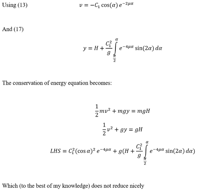

I've tried to substitute (13) and (17) into the LHS of the energy conservation equation, but the result is quite messy and my gut feeling is that it doesn't simplify in a nice way to achieve equation (18). For example:
My Maths teacher has looked at this and is also confused as to how the author arrives at (18).
I realise that having to slog your way through this paper is not a trivial task, so any help or insight into how the author arrives at (18) is deeply appreciated. My gut feeling is that there is a simple physics principle applicable that I've missed from which (18) follows.
Relevant symbols used in the paper (for your convenience):
- μ is the coefficient of friction
- α is the angle formed between the unit tangent vector of the point on the curve being investigated; φ I believe is the same, but specifically as a function of time. The notation used is a little confusing.
- C1 is introduced as a constant of integration in (13)
- H is the starting height of of the ball above (0,0), i.e. the maximum y-value the ball possesses
