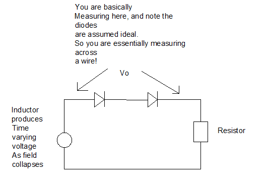

Hi, I'm analysing the the circuit here
http://imgur.com/a/23GUZ
And I'm having some trouble understand the Vout waveform and why it goes to 0 when when pi<wt<pi+a
If there is always an output current wouldn't there always be a voltage out? The only thing I could think would be the voltage across the inductor cancelling out the voltage across the resistor?
I swear this looks exactly like an old professor of mine hand writing (uddin?)
To answer your question - the Vout waveform goes to zero because both controlled rectifiers (T1 and T2) are not conducting (reverse biased). Are you aware that inductors oppose changes in current by creating their own current flow by using their own stored energy? that is what is happening here.
The path that io is flowing is through the resistor and inductor and through diodes D1 and D2. And you are correct, the inductor is creating the voltage that is dropped across the resistor. think of the path through D1 and D2 as a wire in a conventional circuit and Vo is basically putting your meter across it.
FYI - diodes D1 and D2 are acting like "flyback" or "freewheeling" diodes during this part of the cycle.
