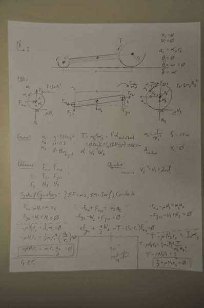

I'm building a little model vehicle that will be powered by a twisted rubber band.
Givens:
m_front wheels
m_back wheels
m_body
coeff. of friction (static) = 0.2 assumed
T = Torque applied = 0.86 N-m based on lab tests
Weights (of above parts) by multiplying 9.81
wheel radii
After using FBD's and Conservation Principles, I have 9 equations (3 from each Free body diagram ... Fx, Fy, and Mz summations equaling either zero or m*a depending on the acceleration happening).
Unknowns, Forces btwn parts (Fx, Fy), and the Normal Forces btwn the wheels and the ground.
I fed this understanding into Excel's solver add-in ... and I'm having trouble identifying the best objective function to use.
My overarching objective is to have the fastest vehicle, but the velocity calculation for anything with a wheel (assuming constant acceleration) is just a function of the input Torque, mass and the radii of the powered wheel.
I want to use solver to optimize the vehicle velocity and solve for all forces.
Am I missing something elementary here?

Without seeing the specific equations, I can't offer much help. Your approach is definitely correct, but when you say "vehicle velocity", I assume you mean the velocity after the elastic band becomes completely unwound? Remember that the elastic band loses torque as it unwinds; I don't know whether you've taken that into consideration in the calculations.

Hi,
Attached is my free body diagrams and equation set.
Even when trying to solve for my forces by hand, I'm running into inconsistencies ... by default (summation of forces & moments ... I should have 9 equations, right?) ... but I have fewer unknowns which doesn't seem right.
Am I missing something here for this simple problem?
And I'd love to use Excel's Solver to quickly solve for all forces quickly because I will have to use this understanding with much greater complexity and over several iterations.

Hi all, I would be greatful for a 2nd pair of eyes on my system of equations. What am I missing?

i think there is an error in your torque equation on the right bottom side of the page.
T-uNr is the net torque producing the rotational accelerationas per your lhs
but on the RHS of the equation you have used T as the net torque producing eqn as you have substituted ALPHA value by T/mr2.
instead get t as function of time the get alpha as function of time.
use omega= omega at zero time + alpha*t for getting velocity at any time t
