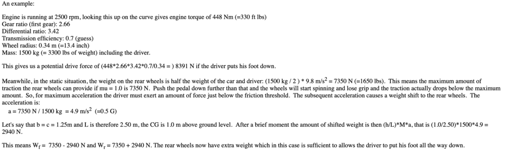

Hello, I am trying to simulate the dynamics of a vehicle accelerating from a standstill to top speed. The vehicle acceleration equation is:
Av = (Ft+Ff)/m
Where Ft = Traction Force, Ff = Friction Force (From Drag and Rolling Resistance), and m = Vehicle Mass
My problem here is that the traction force depends on vertical load on the tire, which also depends on the acceleration of the vehicle.
Wf,r,d = Wf,r,s+(h/L)*m*A
h = vehicle height, L = wheelbase, W(f,r,s) and W(f,r,d) is the static and dynamic weight (load) on the front and rear wheels.
The Traction force is calculated by multiplying the vertical load on the tire by the longitudinal tire force aka normalized longitudinal force. The latter is determined by using Pacejka's Magic Tire Formula. What I don't understand is how am I supposed to calculate the acceleration if the acceleration is needed to calculate...acceleration?
Here are some screenshots of the website I am referencing:
244608
244609
It says "after a brief moment, the amount of weight shifted"... does this mean I need to use the acceleration from the previous time step for the weight transfer?

No it all happens at once. Suppose you wish to solve for the maximum acceleration you can achieve before slipping. What does that equation look like?
Well, I assume it would be the instantaneous tire load multiplied by the friction coefficient divided by the mass of the vehicle:
Am = Wm*Cf/mWouldn't this be it? Or is there another way?

Yes and the instantaneous tire load implicitly contains A. Put that in explicitly and rearrange to again get A. This will give the max A without slipping but includes the dynamic loading.
