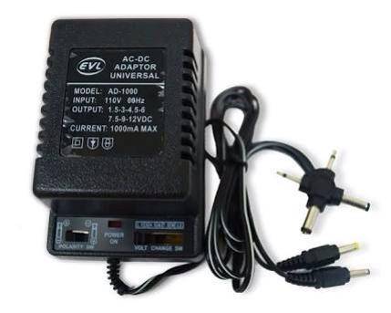

I used to use one if these for electronics projects, it was really helpful. No need for batteries. The downside would be the limit current in the device.

on the face of it, they are attractive but they need to be operated correctly, with a regulator circuit, or they can explode due to over-current. If you are in education then your power supplies have to be totally kosher (as your risk analysis advice should have warned you when you were training). You just do not need any form of accident with kids. It really spoils your day.
Lead acid batteries behave better and (as long as they are appropriately fused) will not let you down.
Lab power supplies, with variable output voltage, are available and are more 'acceptable' for use in Schools. Cost a few tens of GBP or USD each. More than cheapo mains adaptors but better suited to your requirement, being safe and robust.
