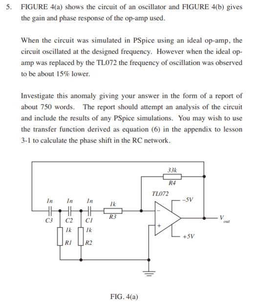

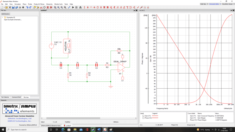

I have been given an assignment relating to RC phase shift oscillators. For me to confirm my findings I require a bode plot read out. However, after many attempts, countless videos and reading material I am still unable to achieve anything. Can some kind person point me in the right direction?.
Drawings attached.

I would start by simulating the circuit without closing the loop directly from the output to the input. Get the Bode Plot of the transfer function with a signal source driving the input first, then you can close the loop and run a transient plot to see if it starts up and oscillates. What are you looking for on the initial Bode plot to predict where the oscillation frequency should be? :smile:

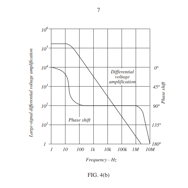

BTW, the Bode plot that is included in the problem appears to be the open-loop gain of a unity-gain stable opamp by itself. It's definitely not the Body plot they are asking you to find...

Thanks for the reply! I’ve calculated the frequency of oscillation of about 65kHz. I was hoping to graph both an ideal op-amp and a TH072 op-amp and compare them. Another issue I’m having is with the unwanted capacitances within the TL072 and how to determine the value of them. Unfortunately, op-amps are not something I deal with day to day so I am struggling a lot with this particular subject.
* At first, you should verify if the oscillation condition (Barkhausen) is fulfilled: Loop gain (somewhat larger than) unity with zero phase shift at the desired frequency fo.
* For this purpose, the loop gain (gain of the complete open loop) has to be analyzed (ac analysis, magnitude and phase) . You should open the loop at the node left to C3 for injecting an ac test signal.
* This analysis should be made for the ideal as well as real opamp model. You will notice a remarkable difference - caused by the unwanted (but unavoidable) reduced open-loop gain Aol as well as phase shift introduced by the real opamp model (if it is a good and realistic model).
* For this purpose, you should not use the graph as contained in the data sheet (and reproduced in your contribution). The graph shows a parasitic phase shift (at 65kHz) of zero deg which is not correct (too rough). To verify the real contribution of the opamp model you should perform a separate ac anylysis of the opamps open-loop gain Aol and phase response .
Yeah I thought that 65kHz was abit off as I calculated the single stage phase angle as 68 degrees each for the RC ladder network, when I was hoping for something along the lines of 60 degrees. Thanks for the pointers, I am going to make an attempt tomorrow.
That plot is on the manufacturer data sheet for the TL072 Op-Amp. It shows the phase shift as 90° at 65kHz.
Cheers,
Tom
Yes - I know.
However, as I have mentioned (and as you can see), this diagramm is not exact enough for calculating the real phase shift within the loop. The simulation model is much more exact.

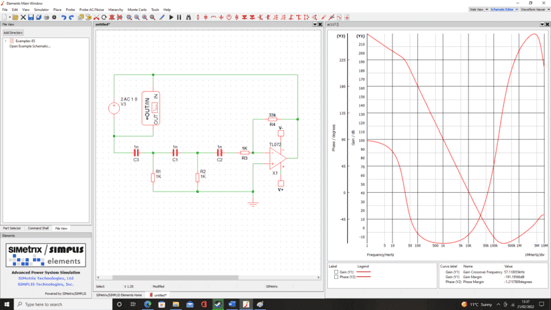

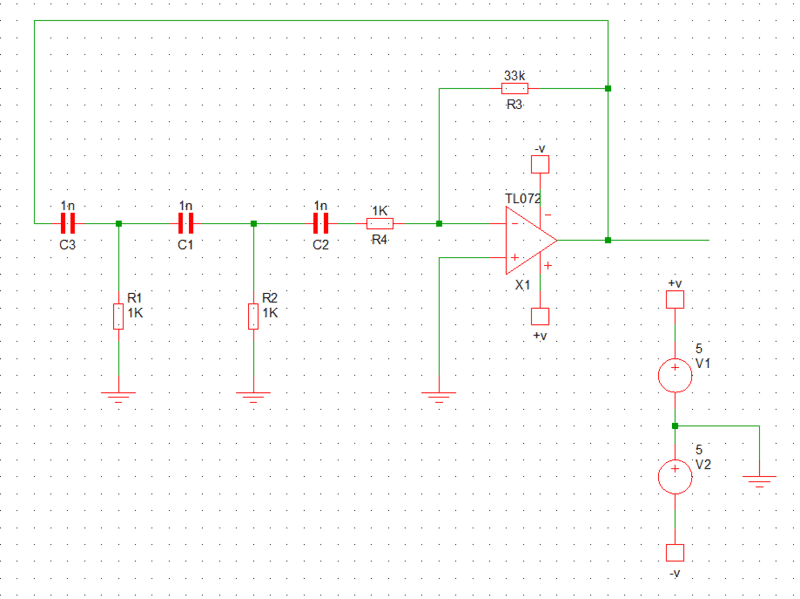

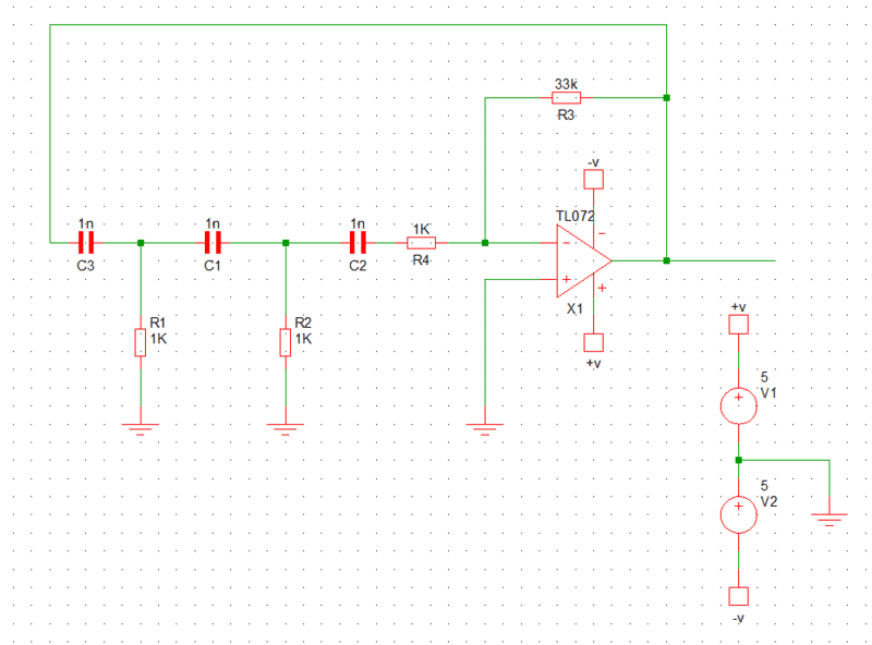

It’s been a while (sick family member and so on..) but I’ve finally found some time to give this another go. I recreated both circuits and inserted a bode plot, to the left of C3 to gain the following graphs. I’m not 100% certain that I have all the settings for the simulation set correctly or in a manner that would make the results clearer or even correct. Hopefully I’m somewhere near.
..."both circuits..." What is the difference?
Circuit diagrams and both graphs are hard to read.
Which variables are shown in the diagrams?
Loop gain?
What is your outcome?
