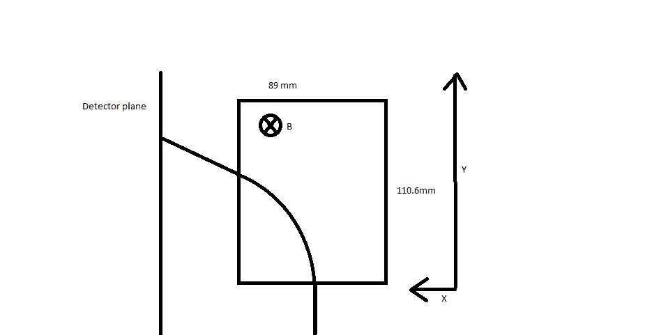

Hello,
sorry for this stupid question but I am getting confused with equations and I need some help.
My problem is the following:
I have a dipole with known magnetic field (B=0.234T), it is 110.6 mm long and 89 mm wide (mechanical dimensions).
I want to calculate deflection of particles (electron with energy E = to 1, 2...30 MeV) and where to expect them on a detector parallel to the long edge of the quadrupole and set at a distance D.
if the detector is behind the magnet I can easily calculate its position, but the confusion I have is that in this case the detecor is on the side and I am going crazy with calculation.
I know energy, and mass, so I know curvature radius in this B=0.234T. I can assume the electrons have main axis in the middle of the magnet, so that they enter at x=0 and their x coordinate at the output would be x=44.5mm. But I am not sure on how calculate the y coordinate and then the angle. In principle if I can get y and angle I can just make it go string and I will know position on the detector... and also some of them might be reflected back if the energy is to low...
Ok, let's put it this way: how to calculatex and y coordinates at the magnet output?
Would you please help me? If my description in not clear I am attaching a sketch.
I could make some quick tracking simulation but I want to solve it analitically first...
Thank you
F.

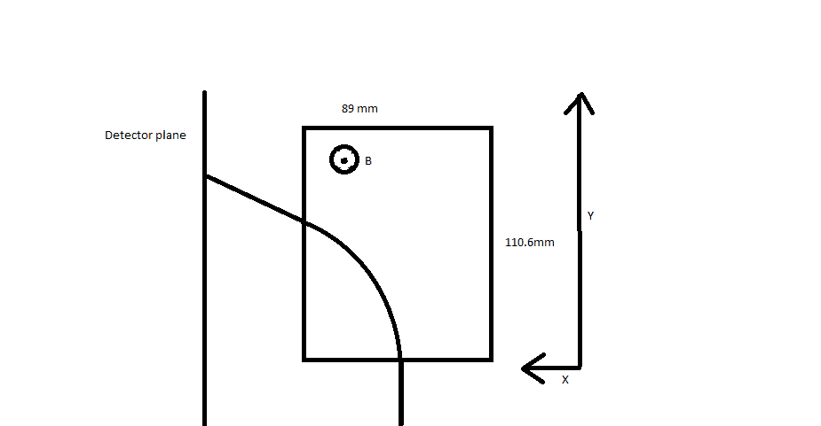

Are you sure that your electrons will be deflected to the left in your diagram?
they will go right, my bad, sorry. now it is correct, I changed direction of B.
ok, somehow progressing!
So, trajectory are arcs of circles that are all tanget to the input velovity and their center are on the axis I made in red. This axis also contains the side of the magnet which is long b=89/2 (for example)
So if the electron has 2R<b it will be reflected back from the same entrance side.
If 2R>b but R<b it will go out from the long edge but it might not arrive on the detector if it is too short. if it has R>b but R<110.6mm it will be going out from the long edge. if R>a it will go out from the short edge on the opposite side of the manget. See attached picture
Am I correct?
Now I need to take it as geometric problem...

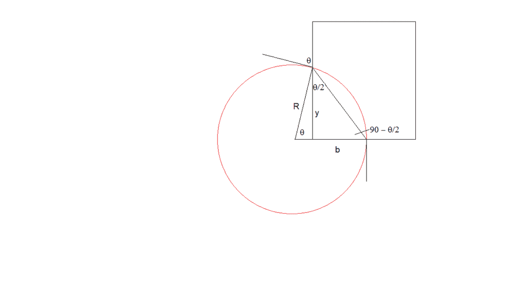

ok, my memories of geometry are quite bad... any hint?
See diagram below. Given b and R, can you find y and θ?
Hint: you might find useful the formula sin θ = 2t/(1+t2) where t = tan(θ/2).
well, the triangle has 2 sides equal to R and the 3rd is the chord, so one angle is Theta, the other two are both equal to 90+theta/2.
I need to figure out how to find theta/2... thinking
hmm... what if:
y = R sin (theta)
and
b= y tg (theta/2)
if this is the way I can say
tg (theta/2) = b/y= b/R sin (theta) = b / R(2t/(1+t^2))
so now I have t=b / R(2t/(1+t^2))
and, if I am not making a mess with calculation, I can say that
t= +/- sqrt(b/(2R-b))
does it work?
hmmm, I'm not really sure this is the correct way...
Why not? You get expressions for the unknowns in terms of known quantities.
I don't know, I'm not really sure. I have the feeling that I made some mistake.
I did the math a few times and I get the same expression again and again... so maybe there is no mistake.
Can you please doublecheck?
It's right. (At least, it's what I get.) What makes you think it's wrong? Put in some values for b and R, and see if you get sensible-looking answers for y and θ.
I put values and it works... but now I know why I thought it was wrong:
some particle will be reflected back (if R<b) some on the detector placed on the side (if R>b and R<110.6mm) and some would go on the front detector.
It is like in the pic I posted.
So, now these expressions for y and theta tell us what happens if all particles are going on the side... it is like my formulas at the beginning to see what happens if they go on the other side of the magnet...
I want to find something more general, to consider all the 3 cases.
I could do a small program with and if loop, but I want to do it analytically!
R < b still works. It's when R< b/2 that things change. And the other transition is not at R = a, but at y = a and θ = 2*arctan(b/a).
