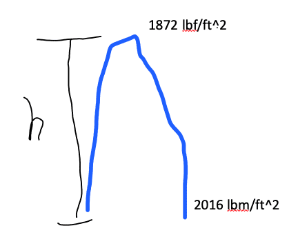

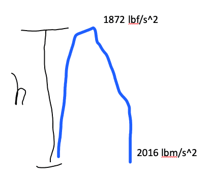

determine the height of the mountain from the data shown. Consider the average air density of 0.074 lbm and g= 32 ft/s^2
p = p*g*h
i have the first convertions of the atmospheric pressure:
1872 lbf/ft^2 = 89,632.6 Pa
2016 lbm/ft^2 = 96,325.4 Pa
g= 9.72 m/s^2
But, i don't have idea how pass the air density of "lbm" to international units ;,(. And other cuestion: its fine pass lbm/ft^2 and lbf/ft^2 to Pa simirlarly?
The units are all over the place here. Is this the actual problem statement word for word and is the image from the problem?
  • Density should have units of mass/length^3, but lbm is a unit of mass only.
  • The units in the picture show lbf/s^2 and lbm/s^2 for the pressures. These are wrong as the dimensions of pressure are force/area while lbf/s^2 is force/time^2 and lbm/s^2 is mass/time^2.
I'd really recommend getting the input units correct before doing anything else.

yes, i wrong in the densty, its lbm/ft^3. yes, the units of pressures its lbf/ft^2 (top) and lbm/ft^2(bottom) (my mistake, sorry). But, i too have the question about these units: why lbf and lbm?

Ok, the lbm/ft^2 is probably a mistake on the problem writer's part. It should likely be lbf/ft^2, which is the correct units for pressure (force/area).
Regarding your question on lbm, 1 lbm is defined as the mass for which the gravitational force in standard Earth gravity is 1 lbf. Since F = mg, 1 lbf = (1 lbm)g or in other words: 1 lbm = (1 lbf)/g. If you convert the 1 lbf to N and insert the appropriate value for g you will get the numerical value for 1 lbm expressed in kg. In order to get the SI units of kg/m^3 for the density, you will of course also have to convert the ft^3 to m^3.

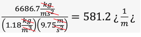

I have all the units in international system, but i can't eliminate the s^2 of gravity and obtain m:
The unit Pa is not kg/m^2 [mass/area], it is N/m^2 [force/area], which equates to (kg m/s^2)/m^2 = kg/(m s^2).

Oohh, thanks for that, now i can eliminate the units, i don't know if i was bad because i got 1/m in the result:

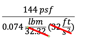

then it would be something like this?:

It should be $$\frac{144\ lb_f/ft^2}{0.074 \frac{lb_m}{ft^3}(32.2\ \frac{ft}{s^2})\left(\frac{1}{32.2\ \frac{lb_mft}{lb_fs^2}}\right)}$$

thank you so much. I understand all the process, except for the 1/32: where does it come lbm/lb?
It is the factor that converts lbm to slugs. Those units are the same as lbm/slug

$$32.2 lb_m=1\ slug= 1 \frac{lb_f s^2}{ft}$$
oooohhh, and 1/32 its because we can eliminate with the other 32. Ok, i get it. Thank you so much again for your time, Sir.
You just did the cancellation of the length units wrong. Nominator has one negative power of length, denominator has three negative and one positive power of length so two negative powers overall, thus the power of length in the final result is one positive power of length, i.e., meters.
