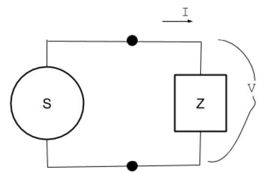

I'm afraid your misconception is more basic. Consider the following circuit.
Let Z be an impedance constructed of any combination of R, L and C you please, series and/or parallel connections, as many passive R, L, C components as you please. The voltage measured across Z is V, and the current through Z is I.
Let S be a source. It could be anything, a mains plug, a signal generator, a battery , or whatever. We'll exclude DC, but S is a periodic signal of any shape.
Z and S are connected only via the two terminals (black dots).
Now, if you allow V, I and Z to be complex numbers, Ohm's Law determines the relationship ##\frac{V}{I}=Z## between voltage and current. Nothing that S does can change that.
If S is not a sine wave, then it can be represented as a Fourier Series which has several harmonic frequencies. ##\frac{V}{I}=Z## applies separately to each harmonic, and the total is the sum of all harmonics. Changing the fundamental frequency of S can change Z, but still ##\frac{V}{I}=Z## . The relationship between V and I depends on Z, not S. Changing the waveform of S, changing the phase angle of S relative to some external reference does not change ##\frac{V}{I}=Z##.
So, what you say your objective is, to change the relationship between I and V using adjustments in S is theoretically impossible. That can be done only by changing the contents of the box Z. I hope that I'm making the message clear.

yes, you made this clear , thanks for the explanation.
but my question about the classical case of an capacitor connected to an induction motor is true isn't it ? where you basically control how far in the grid the "Z" imposed phase shift goes , that's like PFC correction in smps , one cannot change the phase shift of the mains input rectifier or the power of the switches being taken mostly from the peaks of the rectified sine due to stored charge in capacitors but the PFC circuit changes the properties of this connected Z load as to make it more resistive in nature ?maybe a little different question , but then increasing voltage through an inductive or reactive load both increases the real power flowing in the circuit as well as reactive but the proportion by which both increase is determined by the phase angle and at some phase angle (45?) both real and reactive increase at the same rate ?
