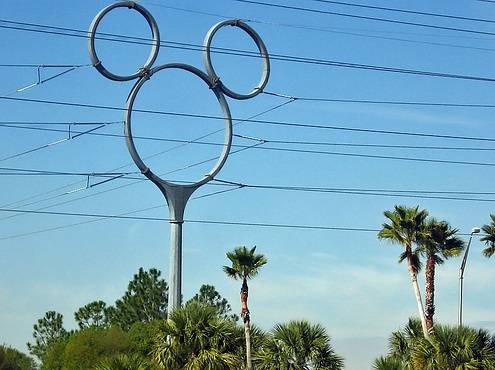

Who hasn't seen this one at Disneyworld?
