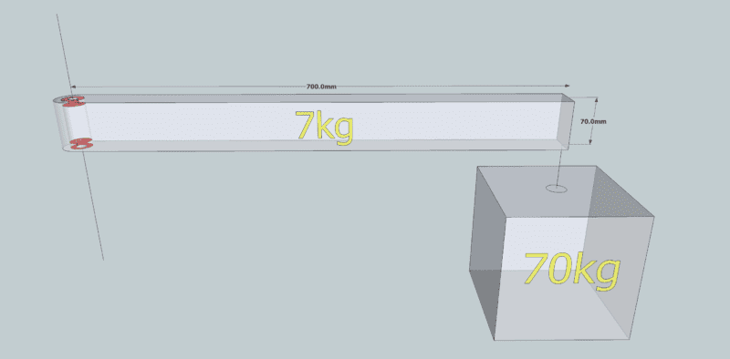

Hi all. I'm designing a custom spare wheel carrier for my 4wd and currently seeking knowledge on which bearings to use, so I need to work out what force on the bearings will be when it's open (closed will be locked and fully supported!)
The example image is simplified for calculation. Close enough is good enough because the wheel itself would be no more than 25kg and I'm allowing 70kg to play it safe.
See below for details...
Simplified 3D model of a horizontal beam pivoting at its left end, 700.0mm long and 70.0mm high, labelled 7kg, with a cube hanging from its right end labelled 70kg.
Thanks in advance folks, much appreciated! :peacesign:

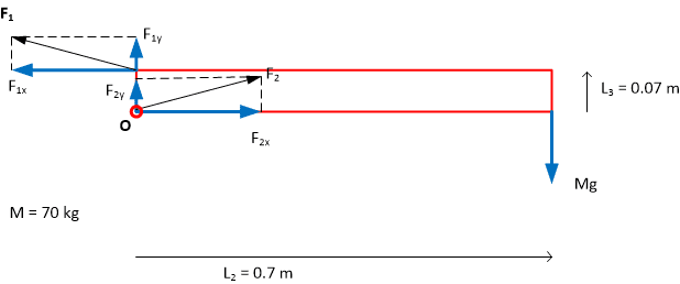

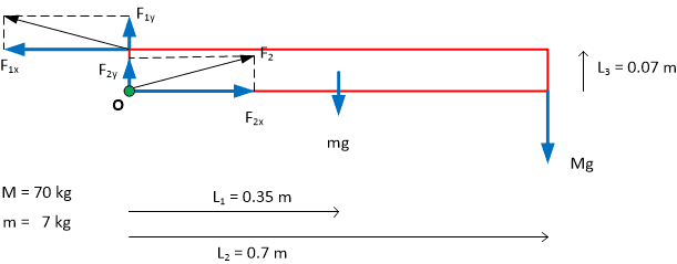

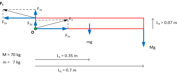

Here's what I make of the situation:
Free-body diagram of a horizontal beam pivoting at point O, with forces F1 and F2 at two bearings resolved into F1x, F1y, F2x, F2y, weight mg at the midpoint, Mg at the right end, and labelled lengths L1 = 0.35 m, L2 = 0.7 m, L3 = 0.07 m, M = 70 kg, m = 7 kg.
##F_1## is the force that the upper bearing exerts on the beam. ##F_2## idem, lower.
Vertical and horizontal components are ##F_{1y},\ F_{1x},\ F_{2y},\ F_{2x}## .
These four are your unknowns. Magnitude of ##F_1## and ##F_2## follows from ##F_1^2 = F_{1y}^2+ F_{1x}^2##. Similar for ##F_2##.
In equilibrium there is no acceleration of the whole lot, so the sum of forces is zero.
In equilibrium there is no rotation of the whole lot, so the sum of torques is zero.
Forces:
In horizontal direction: $$F_{1x}+F_{2x}=0$$
In vertical direction: $$F_{1y}+F_{2y}+Mg + mg=0$$
Torque, e.g. about point O:$$F_{1x}\times L_3 + mg\times L_1+Mg\times L_2 = 0$$
That's three equations for four unknowns.
A sensible fourth equation is to assume ##F_{1y}=F_{2y}##.[edit] ##g## is ##-9.8## m/s2 in the upward direction and I updated(*) the equations accordingly. Hence the ##+## signs.
(*) i.e. corrected the torque which now has signs consistent with the signs in the sum of force equations...:rolleyes:
  • Free-body diagram of a horizontal beam with two bearing forces F1 and F2 resolved into x and y components at the upper and lower supports, with point O marked, weight mg at 0.35 m, weight Mg at 0.7 m and a 0.07 m dimension labelled L3.

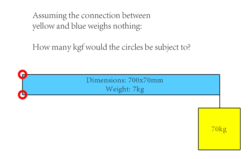

Thanks for the reply but I don't understand a single piece of it :confused:
Was that copied and pasted from another post or was it specific to this post, I don't see any kgf, Newton or kg's and now more confused.
I thought it would be a simply triangulation of weights.Here's a simplified example
The top circle would have a pull force from the right, the bottom circle would have push force to the left.
Diagram of a blue horizontal bar labelled Dimensions: 700x70mm, Weight: 7kg, with two red circles marking its left end, one near the top edge and one near the bottom, and a yellow block labelled 70kg hanging from the right end by a vertical line.
Would I be safe to say this is correct?
Two diagrams of two black dots joined by a line, each resting on a large square labelled 70kg. Left: a 70kg arrow points down at the top dot, the line is vertical, with 90° marked. Right: 105kg arrow points at the top dot, a 45° angled line, and 35kg arrow points left at the lower dot, with 90° marked.
I'm trying to understand the basics first

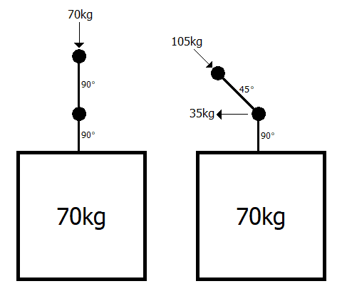

I do not understand that last diagram with angles, 35 kg and 105 kg.
Two side-by-side diagrams of a 70kg block with a bar hanging from its top, load arrows and angle labels. Left: 70kg load on top of a vertical bar, 90° marked. Right: 105kg and 35kg loads on a bar at 45°, 90° marked at the block.
No.
Left picture: The Earth is pulling down the 70 kg with a force of ##F= Mg##. The load M will not fall down if the beam exerts a force that is the same magnitude, but in the opposite direction. If we take ##g = -10## m/s2 (negative to indicate it goes in the negative y direction) that means the beam exerts a force of 700 N upwards. And the force exerted by the mass M ON the beam is 700 N downwards. The drawing in post #2 concerns forces on the beam.
Right picture: There is no relationship with the diagram in your post #1, so it's hard to comment. E.g. I don't see a 45 degree angle.
Clear so far ?

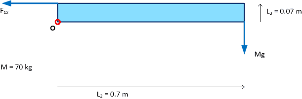

If we take a step back and ignore the mass of the beam itself, we get the following:
Free-body diagram of a horizontal beam pivoting at point O, with forces F1x, F1y, F2x, F2y and Mg labelled, plus lengths L2 = 0.7 m and L3 = 0.07 m and M = 70 kg.
Imagine the red circle (I adapted to your color scheme :wink: ) as a hinge and concentrate on the torque that acts on that hinge (in particular the forces that cause the torque):
Free-body diagram of a horizontal beam pivoting about point O, with force F1x pointing left at the top, a downward arrow Mg at the right end, labels L2 = 0.7 m, L3 = 0.07 m and M = 70 kg.
We have the 700 N with an arm of 0.7 m that tries to turn clockwise, and the only force that can counteract that is the horizontal component of the top bearing. The lever arm for that one is 0.07 m and we have a torque balance $$F_{1x} \times L_3 + Mg \times L_1 = 0\ \ .$$ Put in the numbers and the result is ##F_{1x} = 7 ## kN.
At this point we have already a fairly good estimate of the force on the bearings.
Before going into refinements: Is this understandable ?

700 kgf is what I estimated it to be but I worked it out differently. Thank you for confirming this and in a clear manner!
The last diagram was me trying to understand from a different perspective on how a vertical force affects sideward force at different angles. If you hang a 70kg weight from rope, grab the rope halfway between the hang point and the weight, now push it until the top half is at 45 degrees. Would I be safe to say that the sideward force applied (in my simpleman way of thinking) would be half of the 70kg weight = 35kg?

Thank you for explaining this in simpleman terms, I understand now. Thanks heaps folks, I appreciate all your efforts to get through my thick head haha! Now I can aim for bearings that are rated at or above 700kgf and know that they won't collapse.

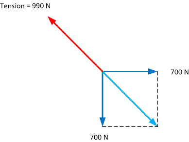

Unfortunately that is too simple. Forces are vectors quantities and that means they add different from numbers. Google 'vector addition' to find the gory details. As a simple example:
Vector diagram: a red tension force arrow of 990 N points up and left, and a light blue resultant arrow points down and right, with 700 N horizontal and 700 N vertical components forming a dashed rectangle.
The load of 70 kg hangs from a rope, exerts a downward force of 700 N. You push a point on the rope to the right. If you want the rope to be at 45 degrees, you need to push with 700 N. That way the forces ON the rope add to the light blue force towards the lower right.
Magnitude (Pythagoras) :
BvU said:
Magnitude of F1 and F2 follows from ##F2=F_y^2+F_x^2##
comes out as ##700 * \sqrt 2 \approx 990 ## Newton.
Fair. The mass of the beam itself adds 5%
And Pythagoras to include the vertical forces another 2%. ##g## is not 10 but 9.8 m/s2, so that is 2% the other way.
The 7 kN is hefty, so the shaft through the bearings needs to be well anchored (as @Baluncore already indicates).
And the one thing not to do is drive with the beam swung out: any bump can increase g considerably. Plus the possible damage with the thing swinging out in a turn or when braking is huge :smile:

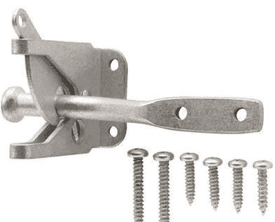

I once hired a Toyota “Troopy” for a seismic exploration. The pin that locked the spare tyre arm in place was missing, so it could swing back and forth into the oncoming traffic. Until it was belayed, the camber of the road kept it in place most of the time. That frame lock should be designed to be fail-safe, without parts that can be lost.
Since the end of a vehicle can sometimes accelerate downwards at better than 2G, a gate latch would need to be spring-loaded to about 5G.
Baluncore said:
and low noise or rattle.
That's an excellent justification.
I wasn't actually suggesting that a gate latch would be for driving - just a hook to park the arm on whilst locking. If the vehicle is parked uphill, you wouldn't want to have to push the arm into place whilst locking. An actual latch would be sure to rattle.
