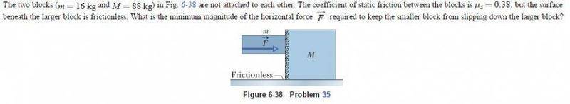

The two blocks (m=16kg and M=88kg) are not attached to each other. The coefficient of static friction between the blocks is us=0.38, but the surface beneath the larger block is frictionless. What is the minimum magnitude of the horizontal force F required to keep the smaller block from slipping down the larger block?
(I've attached the figure in this thread)
Let F be the force applied and F' be the Force of the system
F = mg/[us(1-[m/(m+M)])]
I already know the solution to the problem but I'm having a hard time seeing why the normal force of the smaller block is equal to the total force of the whole system, not to the force applied to the smaller block.

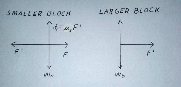

I've attached here the free body diagram which yields the correct answer.
I doesn't really makes sense to me why the positive horizontal force F' is equal to the one horizontal force applied to the smaller block (negative direction).

I don't understand what you mean by that. There are two forces applied to the smaller block, F and F'. F' is the reaction from the larger block, so is equal and opposite to the force on the larger block. F and F' are not equal.
Sorry for not being to specific... I hope this'll get clearer.
My question is why is F' on the left (smaller block), the same as F' on the right (larger block)...
The intuition confuses me
It is fundamental that action and reaction are equal and opposite. I cannot think of a way to make it more intuitive.
