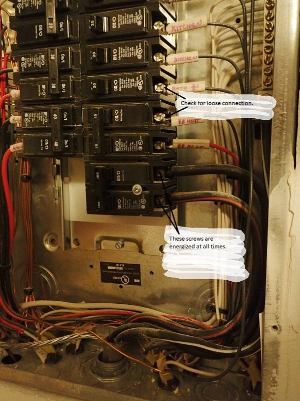

A year or so ago, I had a licensed electrician come in and retroactively fix up some of my wiring (My amateur fingers did nothing near the panel, just extensions to existing lights and outlets). He ran new cable and installed a couple of new breakers for them.
My basement has been gutted to the cinderblocks - so all lines from the panel are open to inspection.
Last week, due to an unrelated issue, I went down to tripped/reset a few breakers. I may or may not have tripped/reset the one in question. I can't be sure because they are poorly labelled.
When I finished, a specific circuit would not come on - the living room lights, foyer and front door external lights - the ones he fixed for me. I cannot be sure this is only one circuit, but it's a good assumption.
Shy of cracking open the panel itself, or inspecting behind the main floor walls, I can't find any reason for them not to work.
I've reset every breaker in my panel, to no avail.
There are only three possibilities, as I see it:
1] A fault in a line in the walls,
2] A fault inside the panel
3] A dead circuit breaker.
The third one is the only one I can check without calling the electrician back.
Do circuit breakers just ... fail?
