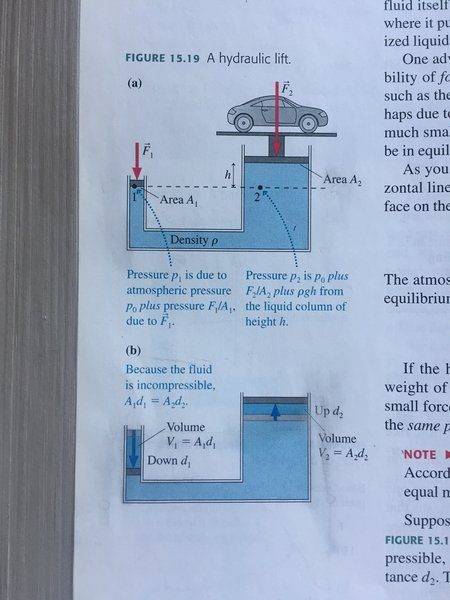

Can you please provide a diagram showing the force that this equation is supposed to be calculating?
Here you go. Let me know if you need more. Thanks.

The solution to your homework problem does not involve energetics. This is strictly a hydrostatics problem. The starting point should be equation 5.11, or, in a slightly different form: $$F_1=F_2\frac{A_1}{A_2}+\rho g h A_1$$The question is "how much does the force F1 have to increase to achieve the new height difference d1+h+d2 (where d1 is the amount that the left level moves down)?"
So deltaF = F1 - F1 (where h is changed to (h+d1+d2)).
I get rho*g*A1*(d1+d2)=deltaF. we can sub "d2 = d1A1/A2" like they show in the book... But this will not help us. Instead use "d1=d2A2/A1" and sub this into d1 and we get rho*g*A1*(d2A2/A1+d2) which simplifies to rho*g*d2*(A2+A1) which is what we were looking for.
