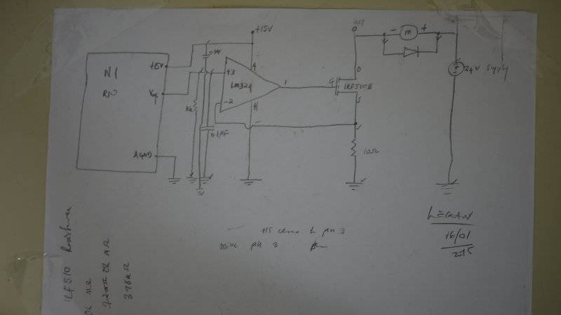

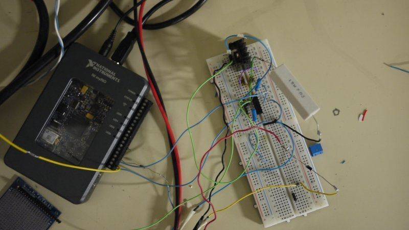

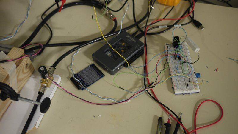

Something strange happened this morning. After blowing up the MC3043, I built a new circuitry all with same configuration and I notice the voltage between the RIO and Pin 3 is 1.65V at max resolution (in the RIO program). I also notice that the voltage at pin 2 is 0.265V which is pretty weird considering it was 1.65V before the other circuit was blown.
jim hardy said:
So place your divider physically very near the RIO and run a wire (or a modest valued resistor) over to pin 3. A few K won't hurt anything because there's ideally no current into pin 3, so you can use a resistor as a non-ideal wire.
This I have done. I also found the resistor beside the power supply and turned up the voltage supply all the way to 26V. I have changed the base resistor to 10 ohms and I am reading same 0.265V across R1.Strangely, I am reading 1.39V across pins 2 and 3. I thought probably my FET was gone but the voltage across the Drain leg and the V+ of the supply is 25.89 telling me all is well here.
Summary: I have bottom leg of resistor, V- leg of OpAMP, and AGND of myRIO all connected together, The voltage I am reading on Pin 3 relative to AGND is correct as it was what I expected since 1.65V flows out of the RIO. But something doesn't seem right on Pin 2.
So - all your power supply voltage is dropped across the load?
What would that say about the current through your load? What's voltage between drain and AGND ? I expect it's quite low.
That says only 26.5 milliamps through R1?
So, have more than 100 milliamps from load sneaked around R1 ?? Or is only 26.5 milliamps flowing through load?

jim hardy said:
IF and ONLY IF volts edit: between mosfet Drain(aka OUT) and AGND are low, like less than a volt or two,
THEN connect an ammeter set for at least 1 amp from Drain to 24v NEGATIVE.
Volts between OUT and AGND is 0.382. I measured the voltage from drain leg to RIO GND and it's same voltage between Drain and GND of RIO.
meBigGuy said:
The OP1177 output will not go all the way to ground, but it will almost turn the FET off. A 10K resistor from the opamp output to GND might help.
jim hardy said:
If you read only 26.5 milliamps then something has gone wrong with the valve , it's restricting current.
That's worse because the valve is I'm sure an expensive piece.
I'm reading 0mA. I am using the HP34401A multimeter since my Fluke was not giving me a reasonable reading (0 ~ 0.2mA and was highly unstable).
One thing though: I put the multimeter terminals across OUT and V+ with load connected and I see 26.2V. I disconnect and I get 25..9V. Meanwhile I am still having the voltage drop of 1.65V across the SET 10 ohms resistor. Pin 2 of Op-AMP is still 0.265V as before.

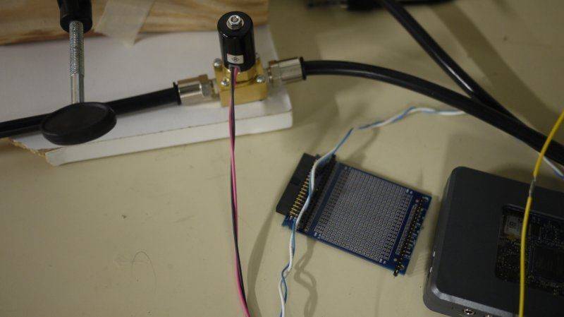

Ok. So to be sure my Valve is still of full integrity, I put a 24V across its terminals and it opened up for air flow. This means the circuit is the problem and not my valve.

Here's what i think happened...
That valve is a solenoid with lots of inductance.
When one attempts to suddenly stop current through an inductor , the inductor opposes that . You've heard of "inductive kick "?
I expected to see a warning for this in the valve datasheet, but didn't. Closest thing to it is that note i cited above. I emailed manufacturer asking about it, no answer yet.
Anyhow i think we have ruint the MOSFET and LM324.
Mosfet died, most likely from inductive kick but possibly from overheating.
LM324 died when mortally wounded mosfet let current flow out its gate into pin 1 . Observe LM324 can only sink 20 milliamps
so our path around R1 is through a burnt up LM324.
Observe on LM324 datasheet at http://www.ti.com/lit/ds/symlink/lm324.pdf
page 2, "amplifier schematic"
output pin goes to a PNP straight to V-, the "rake" symbol , with no resistor to limit current.
If it shorts we have path around R1: of out Mosfet gate edit into LM324 pin1, then straight to AGND.
Good thing you put the voltage divider in there !
Fix is three stage:
1. Eliminate inductive kick by connecting a common everyday diode , like 1N4001 or 1N4148, across valve terminals.
Be sure cathode (stripe) is on +24 side, anode to Load side.
That'll protect next mosfet against inductive kick.
2. Eliminate overheating of Mosfet.
Observe in mosfet datasheet at
http://www.supertex.com/pdf/datasheets/VN3205.pdf
curve "safe operating area" on page 3
it specifies case temperature of 25degC, room temperature
and at 100 miliamps only allows 8 volts drop
i'm sure we are overheating it
we need a bigger mosfet and a heatsink
3 (not mandatory but i'd do it) Protect LM324 against overvoltage on 24V supply
Move LM324's V+ from +24 to a +5 or +12 supply terminal coming from Mr RIO.
We only need to get out of LM324 1.65 volts for R1 and ~1.5 volts for gate drive to Mr Mosfet, total = 3.15 which LM324 should do from a 5V supply.
Now this one confuses me a bit
1. Is SET 10 ohms R1 or is it part of the voltage divider ? Maybe you'd put up a current schamatic, I'm still going on this one which doesn't mention SET 10 :
2.
meaning we get current through R1 when valve is disconnected?
Where does that 26.5 milliamps come from? I'm guessing through a fried LM324.

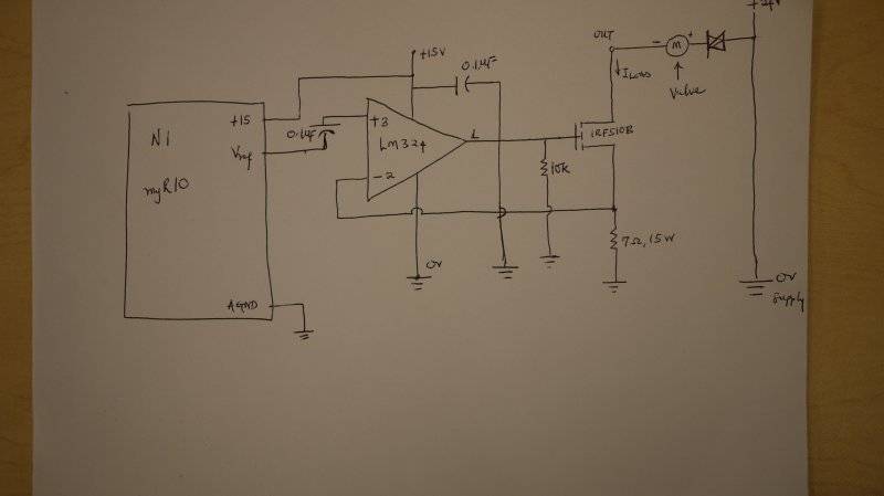

Thanks Old Jim. I will implement the suggestions when I get to the lab this morning. I am so grateful for your willingly offered expert advice. I've learned s!*t! :)
And I will surely post an updated schematic once I get access to a scanner. And yes, the set resistor is the ohm bottom one. Is there a power MOSFET with heatsink that you'd recommend?
If I change the supply pins to either +/-5 or 12V, will we get enough 24V to drive the solenoid? I thought the solenoid works at a voltage of 24V and currents of between 100mA and 165mA? I am not clear about this.

Oh, the datasheet's page 2 deceived me. I will go pick up the IRF510 at a local store in my city this afternoon.
I tried this with the IRF510 but I kept shorting the transistor somehow. Gate - Source resistance is almost zero all the time. I replaced the transistor with another IRF510 extra once and I can barely measure any voltage across OUT and V+. So I replaced this with the spare Supertex I was using before and the voltage drops across each opamp input is back to 1.65V and the voltage across OUT and V+ is 23.16 after taking my V+ supply to 30.89V. I have the V+ of the opamp now wired to +5V of the RIO and all GND are on the RIO. As meBIgGuy early on suggested, I put a 10k resistor between opamp output and GND and I got 1.451 voltage drop across it. I know the 23.16V comes from (30V of supply - 5V of RIO - 1.65V across Opamp input - 1.451 V across 10K resistor. Bear in mind that I am using the MC3043 opamp as opposed to the 324.
But here is a shocker, my valve gets powered but when I vary the voltage across the analog out of the RIO, I am not observing a change in air flow across the valve. Something beyond me.
dont take offense at this
the Supertex has gate on middle lead, left to right S G D
the IRF has gate on outside , middle is drain, left to right G D S
it'd be real natural...
let me decipher the rest of your post it's a lot of observations to tie together...
so the IRF510 isn't conducting ?
Sounds like the Supertex conducts but IRF doesn't. And sounds like the circuit worked with Supertex...at least long enough for you to measure equal voltage at opamp inputs.
that's confusing - it would seem the opamp was trying to turn the mosfet OFF but couldn't... 1.45 volts to gate of mosfet whose source is at 1.65 should turn it off...
and that agrees with this observation
It sounds like we are unable to turn ON the IRF
and unable to turn OFF the Supertex...
Need to split system logically in two so perhaps we can narrow down problem...
Is opamp trying to control mosfet? Let's look.
BTW which mosfet is in there now ?
What is voltage at opamp output with RIO output at zero?
pin1 =
What are voltages at opamp inputs then?
+in pin 3=
-in pin 2=
What s voltage at opamp output with RIO output at max (calling for 165 ma ) ?
pin 1 =
+in pin 3 =
-in pin 2 =
Hopefully that'll tell us which direction to go looking for trouble .

I've been thinking about this last night.
Hypothesis:
Were the IRF installed assuming it has same pinout as the NN3205, which it doesn't,
Source would be at OUT , bottom of solenoid
Drain would be at opamp output pin 1
Gate would be at R1.
The mosfet's internal diode would be forward biased allowing solenoid current to flow into opamp output
probably wrecking opamp
and if it burnt pin 1 open internally, that'd put 30 volts source to gate exceeding its 20 volt rating
and the next mosfet wouldn't pass any current until its gate-source junction failed.
that hypothesis sort of agrees with this observation
and with this observation
and I'm not quite sure what this one means
so let's see whether he finds opamp still working and build from there?

What're your thoughts ? Do you think this thing could be oscillating? Maybe look for AC across solenoid?edit duplicate post deleted
Right now, I have the VN3205 on the board. And BTW, I took cognizance of the connector pinouts of the IRF510 as against the VN3205, big Jim.
Everything I am testing for now is with the VN3205.
pin 1 = 1.468V
+in pin 3 = 1.659V (RIO out is at 1.65V)
-in pin 2 = 1.735
Hopefully that'll tell us which direction to go looking for trouble .[/QUOTE]
Alright.
Note, I am powering the Opamp from the RIO +15V and GND connectors. Voltage across R! is 1.698V
More so, I saw the following, prompting me to think the shunt resistor should be across the motor and V+...and ground the source ?
pin 1 = 1.468V
-in pin 2 = 1.735
Great info! I should have known you'd catch the pinout but one has to ask to eliminate the question. No offense meant.
Good point on +15 for opamp, too.
From your readings
Opamp sees higher voltage on his - in than on his +in, so he should be driving his output as low as he can.
1.468volts doesn't sound real low,
but
a mosfet with its source at 1.698 volts
and his gate at 1.468 volts
shouldn't conduct.
-in pin 2 = 1.735... Voltage across R! is 1.698V
R1 and pin 2 are joined by a wire ? that's a lot of difference... out of curiosity, where is negative lead of 24 volt supply physically connected?
Okay, it looks like opamp is trying to turn OFF the mosfet when we call for full current,
Does he try any harder when we call for zero current?
pin1 =
+in pin 3=
-in pin 2=
Then let's help him and see if mosfet will turn off.
Jumper drain(or opamp pin 1) to AGND
and read again
out pin 1 =
+in pin 3 =
-in pin 2 =
volts ACROSS solenoid, and we'll check for AC in case we'e oscillatng
volts DC =
volts AC = ,, if there's enough to measure get frequency if your meter is so equipped.
now remove jumper from drain and repeat solenoid measurement
volts DC =
volts AC = ,, if there's enough to measure get frequency if your meter is equipped.
That'll tell us if mosfet is capable of following directions he gets from opamp. And hopefully whether he's oscillating.
Old troubleshooter technique - when nothing looks bad, make everything prove itself good.
I'm curious of that 1.4 volts at opamp out
and the 1.735-1.698 = 37 millivolts difference between R1 and pin 2
Is there measurable voltage between physical bottom of R1 and GND ?
